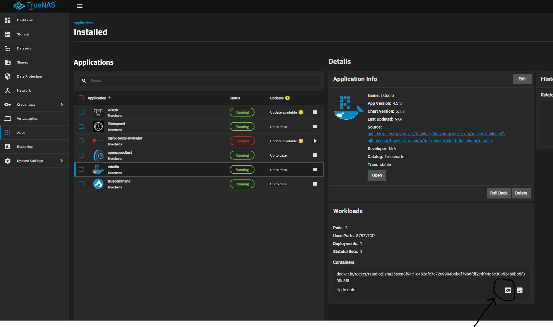

I think I finally understand what @aseimel was suggesting. In Apps, when highlighting the rstudio app, there is an icon to jump into the shell. Once there, you can create a userid and password (I had been trying to do this within the app definition, "Edit -> Image Environment", without success). All seems to work fine until the rstudio app is stopped and restarted, which results in the userid and any projects disappearing. So, I think my problem comes down to what I am focusing on. I want to stand up an RStudio app with a permanent system area (userid, etc.) and working area (my RStudio projects). I would like to learn how to do this for the RStudio app. But it looks like the information on how to do this is not in some specific TrueCharts-RStudio-app-documentation but, rather, is buried in the overall documentation about TrueCharts ... with all of the customization/complexity that has for TrueCharts apps in general. If I were interested/had the time to learn about everything TrueCharts, this would still be somewhat challenging.
