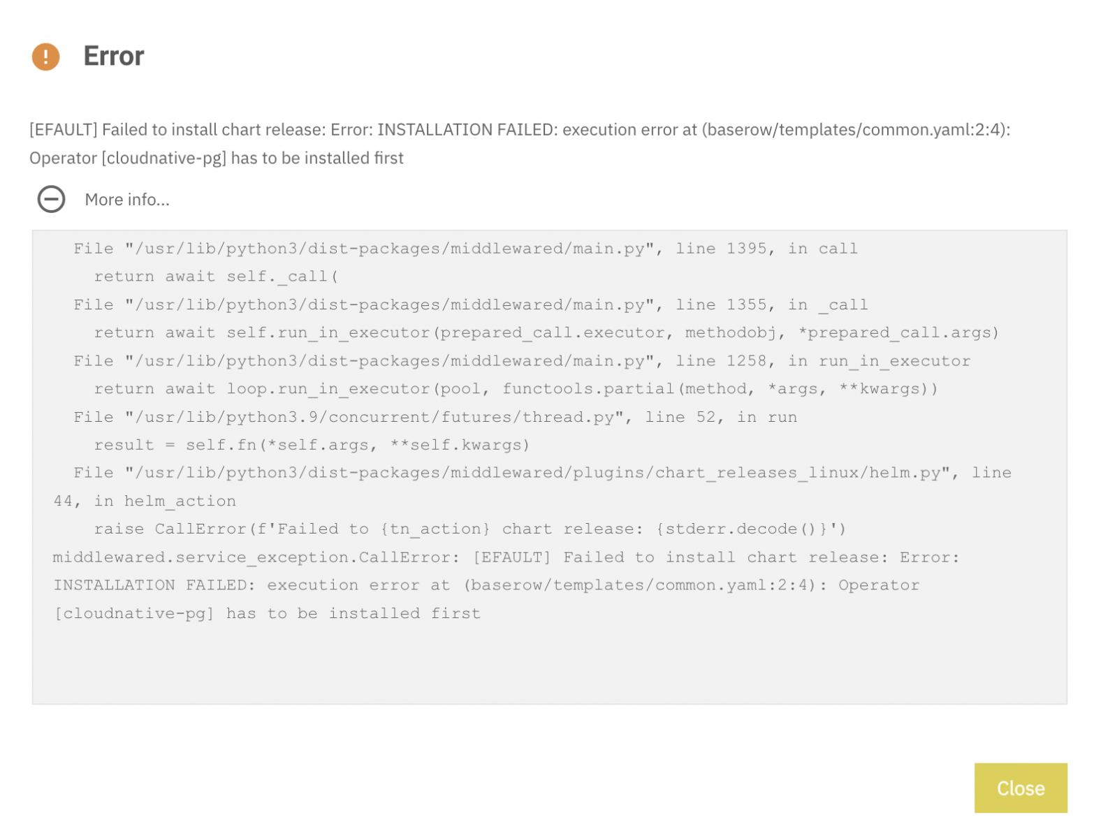

Hi there, I'm running TrueNAS (TrueNAS-SCALE-22.12.3.2) and have been wanting to run Baserow through the TrueCharts docker image repo, however, it fails to install regardless what I do, the error being that cloudnative-pg is missing.
There seems to be no documentation or a way for me to install it manually. I've tried almost every configuration to bypass this and even tried to run it through the CLI to bypass the image error, I did this by following the documentation on the Baserow site, this installed correctly but did not appear when attempting to access it from the port numbers I set.
I'm in a bind as I cannot seem to get this to install or run, I would much rather have this run from the app library than do it manually.
I would appreciate some help if anyone knows where to point me to resolve this.

The obvious solution would seem to be to install cloudnative-pg. Have you tried that? See this 4+-month-old post for more information:
Obvious, maybe, but my understanding with TrueNAS Scale is that everything should be installed via the Application Manager. I could not find
cloudnative-pg
in the package/application manager or find a way to install it via the CLI manually. The link you've provided doesn't quite help me, either it's to a level of competence beyond my skillset, or my understanding of what it is telling me is more relating to updating versions. Leaving me back here with no understanding of how to overcome the problem presented.
Your understanding is correct. If you couldn't find cloudnative-pg as an available application, the most likely reason is that you haven't enabled the Operators train for the Truecharts catalog.
Truecharts provide support for their apps via their Discord; the link to that is (among other places) in the blog post I linked.
Hi there, thanks for your response. You were correct on that, I also needed to install a few other docker images in order to make Baserow to install. Thanks for the pointers there, it helped a lot.
