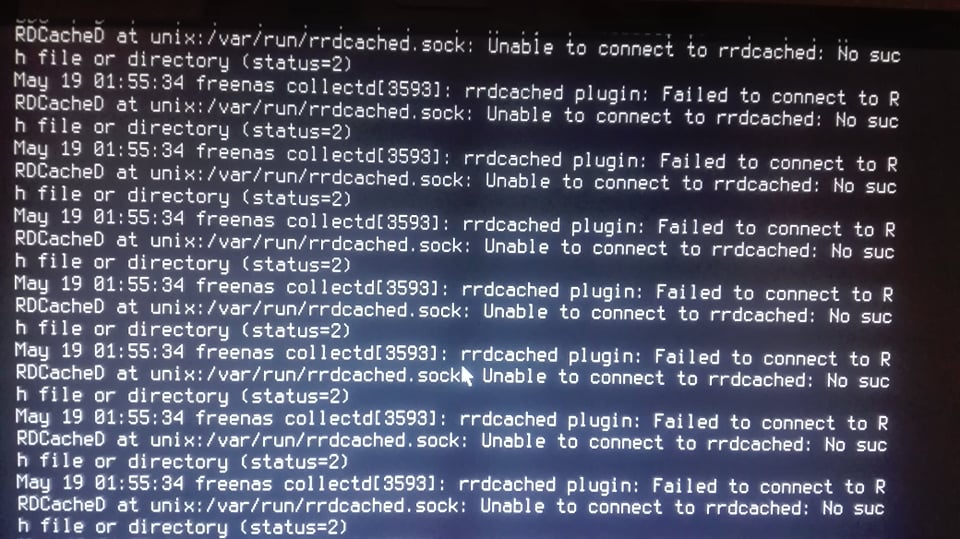

Hello everyone,
Sorry if my english is not perfect, I'm french;)
I have a problem with Freenas since yesterday. My CPU runs between 80 and 90% and the Ram is almost full when I'm not doing anything. I wanted to restart my server and it is very slow to stop. I also have an error message "rrdcached plugin: failed to connect". An image is with the message.
I even planted my boot, I had to reinstall Freenas and use a USB backup key but still the same problem.
For information, I switched to the 11.2-U4.1 few days ago, but I had no problem before yesterday.

daemon.log entry:
Jun 18 07:18:39 {servername} collectd[3374]: rrdcached plugin: Failed to connect to RRDCacheD at unix:/var/run/rrdcached.sock: Unable to connect to rrdcached: No such file or directory (status=2)
... (repeated multiple times within 1 second)
Jun 18 07:18:40 {servername} collectd[3374]: rrdcached plugin: Failed to connect to RRDCacheD at unix:/var/run/rrdcached.sock: Unable to connect to rrdcached: No such file or directory (status=2)
The file /var/run/rrdcached.sock does exist.

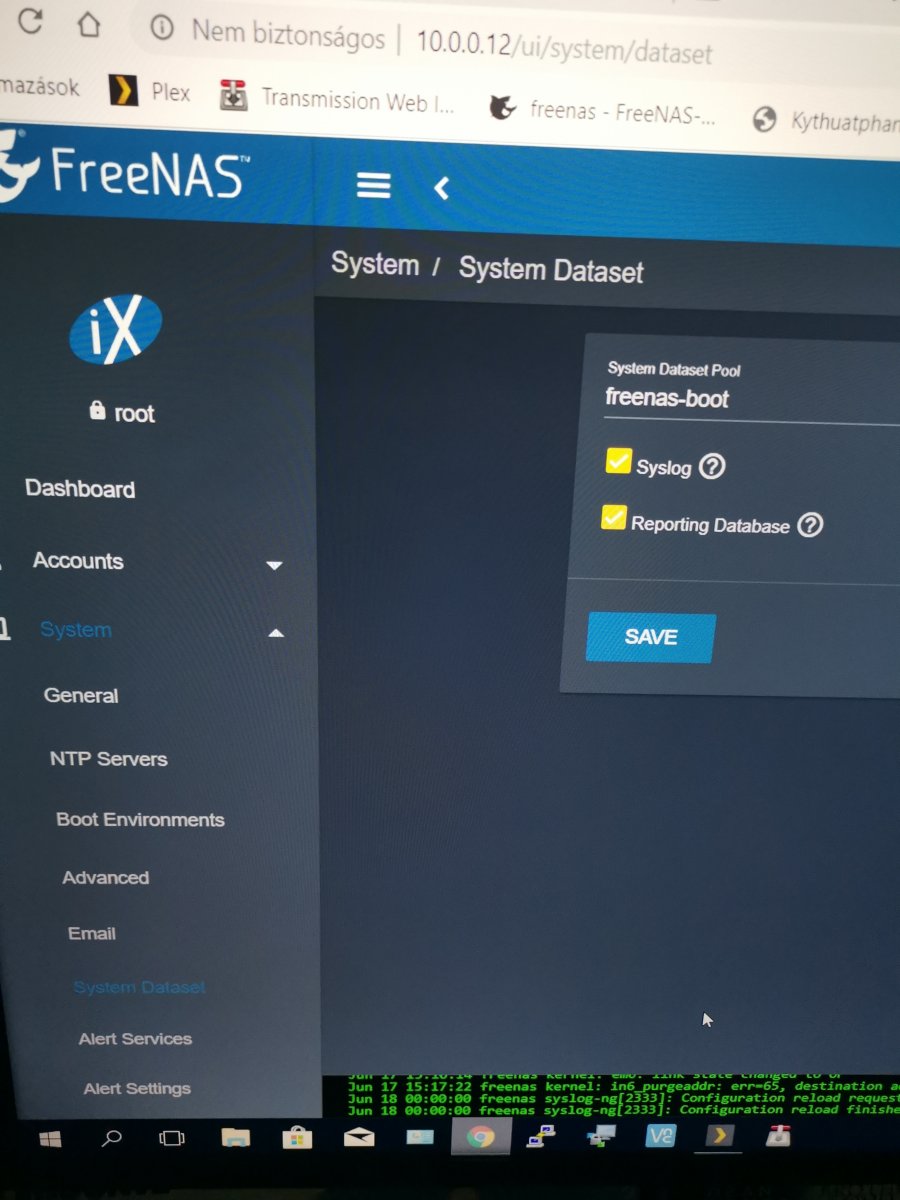

This is the solution!
I just upgraded my FreeNas system from 9.10.2U6 to 11.0 Then to 11.2. Everything went fine.
After shutting down after last upgrade is when I saw the errors mentioned in this thread: "rrdcached plugin: failed to connect". After reading through this thread - I checked the "System / System Dataset" And the "Reporting Database" was not checked. I checked it, clicked save... Then shutdown. Have not seen that error since. Just thought I would add my experience to the thread. Thanks All...
