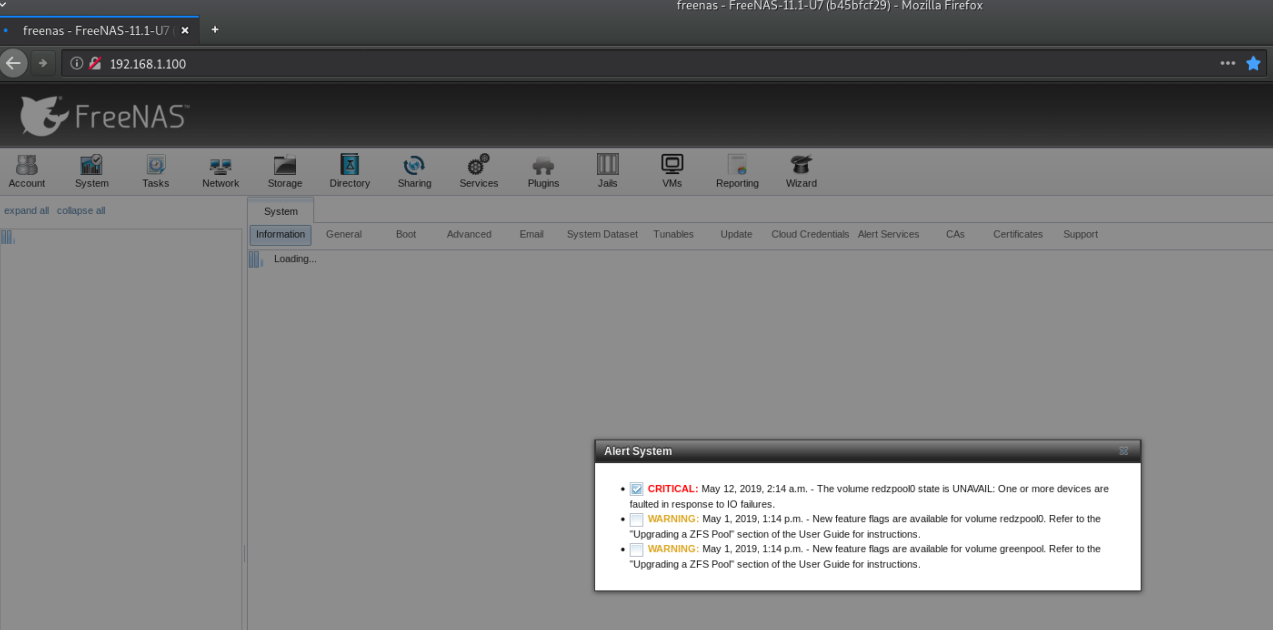

So, I was highly distressed when I logged into the HTTP webclient and saw the flashing red light indicating a critical error, and that apart from the critical warning, the actual web interface was unresponsive (Stuck at "Loading...")(see screenshot). After re-booting the system, I found that many of my reporting databases had been degraded. (see screenshot). None of my other files were active at the time this occurred, so they're probably not affected.

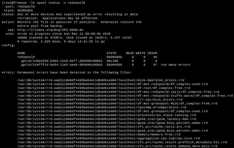

I saw that one of my drives had failed during a recently initiated automatic scrub. It was about 20% through the scrub, which resumed after reboot.
Each time I executed zpool status -v I noticed that the checksum errors (97 in this screenshot) continued to increase, although the actual number of files affected remained the same. It made me nervous that the checksum error count kept rising, because I know that FreeNAS seems to update those reporting databases incessantly, so I just powered down the system. Now I'm not really sure what to do.

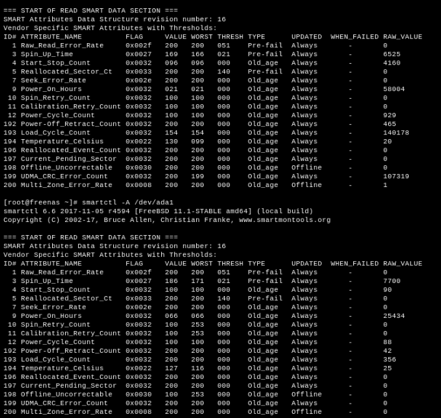

  • is the HDD actually in failure or pre-failure and in need of replacement? (SMART readouts in screenshot)

Part of your problem will be that your pool has no redundancy. It's a stripe of 2 disks.
The SMART data certainly indicates a disk with problems (I guess it's /dev/ada0), a huge number of UDMA CRC errors, so that will be the degraded one. You will not have a good time if you continue to try to use that disk.
With that drive failed, your pool is gone, so get your data off the pool immediately while it is still running. Backup, destroy pool, insert new disk(s) build new pool, restore.
When you get a replacement disk, consider how much you love your data and going with a mirrored pool instead.
There is no option to simply replace the failed disk as removing the failed one will kill the pool.
Don't worry about the reporting databases... they will get recreated when you replace the pool.
The fact that your reaction was to scrub the pool indicates you may think there's something that the system can do to fix filesystem errors... in order for that to be true, you need to have more than one copy of your data (or at least some parity data), which isn't the case in a stripe. ZFS has checksums on your files, so it can see some errors due to that when you run a scrub, but has no parity data/additional copies to recover from when errors are found (i.e. scrubs will only ever find permanent errors for you).

UDMA CRC errors
Sometimes CRC errors are just bad cabling. You might try new cables first.

The disks have very different numbers of power-on hours... did you add them both at the beginning, or was the 2nd drive (the one that is not failing) added about 2 years ago?
For it to be a cabling error after about 58'000 hours of power-on, it would seem a little odd to me unless there was some kind of physical intervention in the box to bring about some kind of change to the status quo.
The two hard drives you gave us partial information on are of different ages. One is reporting 58005 power on hours, if I am reading that photo correctly while the other is reporting 25434 power on hours.
Just to give you some perspective on that, 58000 hours works out to 6.6 years of power on time for the drive. That is beyond the expected life of most hard drives and that is the drive that appears to be faulted. If you are able to get this pool back online, you need to make a backup and start with some new drives.

For it to be a cabling error after about 58'000 hours of successful spin, it would seem a little odd to me unless there was some kind of physical intervention in the box to bring about some kind of change to the status quo.
Perhaps it is wishful thinking on my part, but I have seen a reseat of a connection clear up a data error. It is grasping at straws, but the only hope I see.

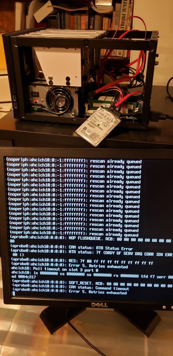

I think the disk drive may not have been the issue. Working with an entirely different drive, I encounter the same error. Some of the SATA ports appear to work better than others, and I think the motherboard is probably to blame.
