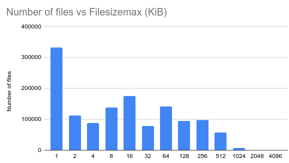

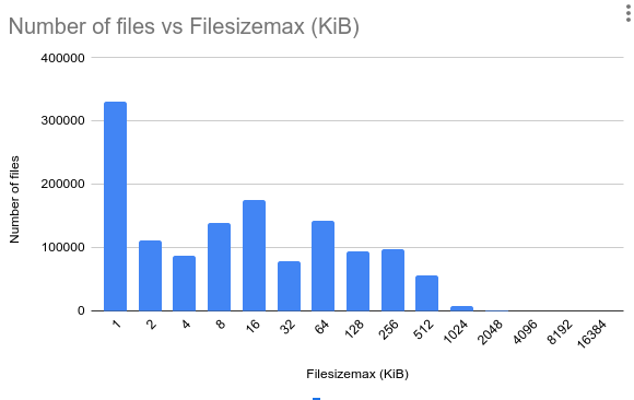

I found this post particularly useful at the L1tech forums.
This oneliner will provide a histogram of filesize and amount of said files.
It is useful to give hints about useful record size on a dataset, and subsequently the size of 'small files' to be captured by the special vdev. In case the special vdev would become "full" it's not the end of the world, records that would've ended up in this "special class" would instead be demoted to "normal class" and end up on the pool as normal. I think that is a point of relief when sizing up the special vdev. I'm still going to try to at least diminish the guess work, as you'll read on about shortly.
As Wendell points out, the size of small files needs to be smaller than the record size for this to make sense.
find . -type f -print0 | xargs -0 ls -l | awk '{ n=int(log($5)/log(2)); if (n<10) { n=10; } size[n]++ } END { for (i in size) printf("%d %d\n", 2^i, size[i]) }' | sort -n | awk 'function human(x) { x[1]/=1024; if (x[1]>=1024) { x[2]++; human(x) } } { a[1]=$1; a[2]=0; human(a); printf("%3d%s: %6d\n", a[1],substr("kMGTEPYZ",a[2]+1,1),$2) }'
I've ran this on my SSD pool, all SSDs about 1TB RAW, 500G used. Default recordsize @ 128KiB.
In total, there are boatloads of small files, and generally pretty much nothing else larger.
There are a few datasets that have very different characteristics.
Most notably - one where qcow2 files are stored, and one where photoprism has its backend store for auxiliary files.

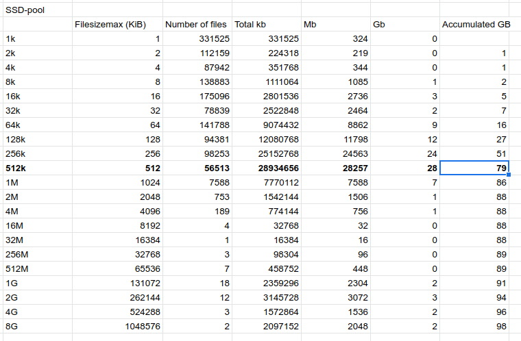

Here's another perspective of the ssd-pool. The idea here is to estimate an accumulated GiB of small block file sizes to better size the special vdev device.
In this case, if I'd run a 1MiB record size, the small block size would be at maxed at 512KiB, which would bring about 79GiB of small block data to the special vdev.
Luckily the small block filesize, as well as record size, can be adjusted per dataset, which brings additional level of granularity.
Diving deeper, looking into specific datasets (providing different paths to the script), I found that mostly all of the file-numbers data came from the same dataset, NFS backends for photoprism that generates humongous amounts of small files. Here's what it looked like:
I did some playing around with setting record size lower, and rewriting the pool (still in progress as it takes some estimated 2days to comeplete). I set recordsize to 4KiB, and small block size to 2KiB. (I'm a bit torn, I maybe should've gone for 16KiB instead. Oh well.)
The qcow2 dataset had only a handful of files less than 8KiB. I set record size to 1M and small block size to 512KiB.
