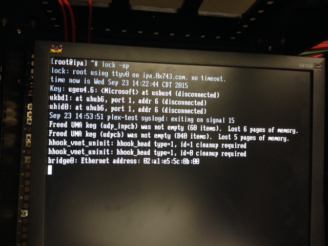

Except when I stop a jail and restart it, FreeNAS crashes. When done via the WebGUI, I find a message like in the image attached. It hangs for a few minutes, then reboots.
