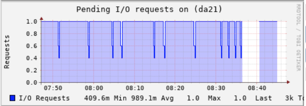

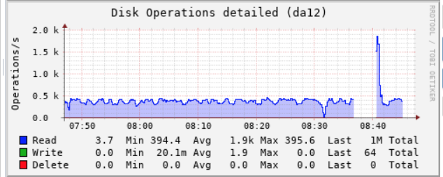

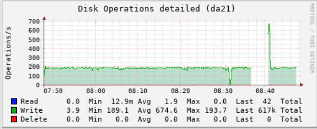

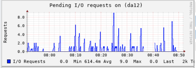

I have no idea how long it should take to resilver a pool of 6 x 8tb seagate drives. I know when I had a Synology Diskstation it would take about a day, Now I did think that after spending a lot of money on my new Freenas things like this would be quicker. After a scrub it was clear that I had a failing drive so I replaced it last night but it soon became clear from the reporting graphs that it was going to take a very long time. The good drives are currently being read at a mere 12mb/s and the same speed for writing to the new drive. This morning I did wonder if there was anything wrong so did a reboot. For about a minute things went fast (see screenshots) but then dropped back to 12mb/s. I also noticed that the resilver % dropped back from about 54% to 43%. Earlier this afternoon I shut down the system and removed my other 2 pools and all associated HBA's, and Network cards but on start up the slow speed persists and also once again the resilver % dropped back from about 61% to 43%.
Non of the disks or system in general is under any great stress apart from the one being rebuilt which is showing 100% busy and the pending i/o requests for that drive appear to be maxed out (da21)
We are constantly told that resilvering puts a lot of stress on the rest of the disks in the pool but with each disk currently showing 12% busy and 12mb/s read speed there doesn't appear to be any danger of another drive failing.
If this is the way Freenas works then it is something I will have to live with but something just does not feel right especially when a scrub can rattle along at over 130mb/s for each disk.
You have not said, but looking at the graphs, I am guessing that da21 is the failing drive. It is taking a very long time to respond to IO requests. That is going to very significantly impact the time to resilver the pool. It would probably be MUCH faster to just remove that drive and rebuild parity from the other three drives. The problem with that is it leaves you with no parity (no protection) while the resilver is happening. That is why we don't build pools with RAIDz1. You need to be able to remove the failed drive and still have a parity drive.
That is being held back by the bad drive. The pool can only read at the rate of the slowest drive and it can't write to the replacement drive until the read is done. As long as that defective drive is still in the pool, the system will continue to try to read from it.

1 - The drives are new Seagate Baracuda that perform well other than this resilver issue.
2 - Not that much data in the pool. I was in the process of transferring from backups so maybe no more than 10% full.
3 - Fully appreciate that Synology is much different but with only 4gb of ram and an inadequate CPU I thought my new Freenas build should perform Better.
4 - ! also fully appreciate and accept the dangers of Raidz1 but it is difficult getting the drives in the space although I have considdered Raidz2 for the 2 x 8 drive pools.
5 - Drive da21 is actually the new replacement drive.
6 - The data is not important which is why I tried a reboot.
7 AS I SAID - DRIVE DA21 IS A BRAND NEW DRIVE WHICH HAS PASSED A FULL SMART TEST RUN ON MY MAC.
Think I will either leave it to finish resilvering or take the drive out and run another SMART test on it from my mac
