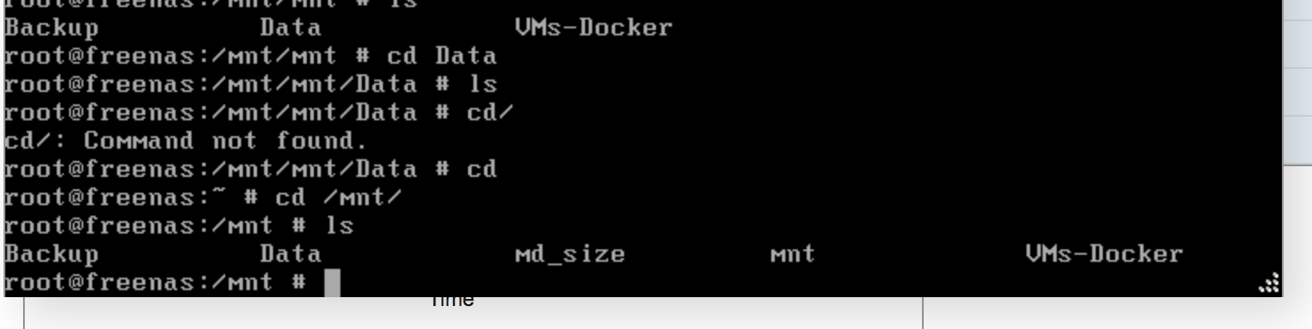

I found a strange mounting point....
in /mnt/ are my 3 pools but also a map called mnt en inside that are my 3 pools. Is this normal? But those /mnt/mnt/Data is empty
