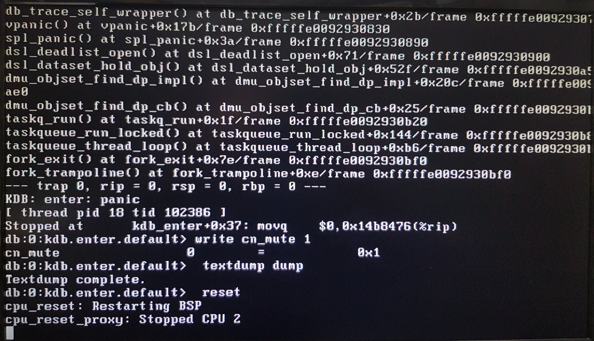

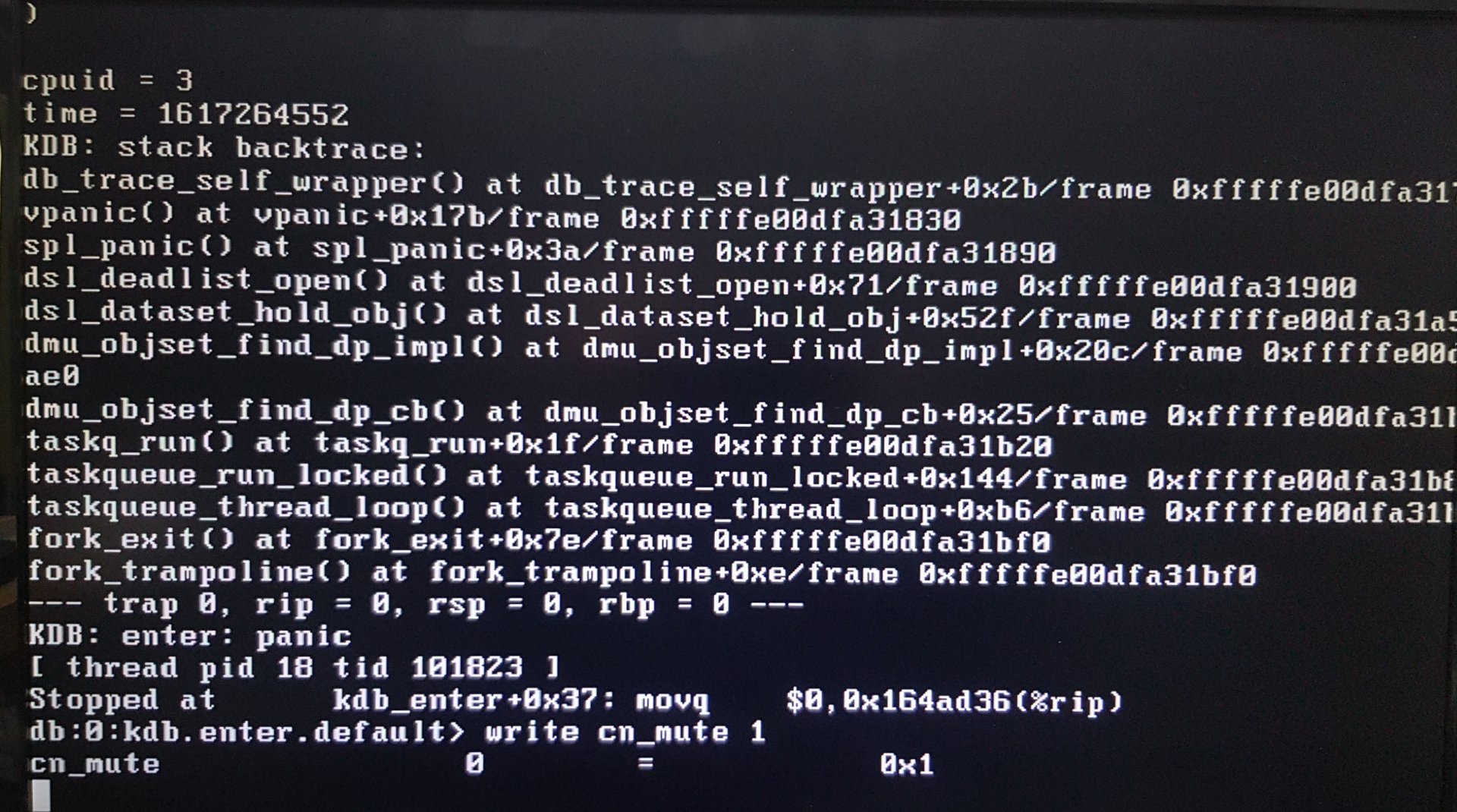

I upgraded my old FreeNas to TrueNas in January, and it has been running all my media files, film and pictures with only minor hiccups. However last week, toward the end of watching a film late one night it started to what i can only call buffering and freezing. I thought nothing of it and went to bed. in the morning i thought i would check to see if all was well with TrueNas and found it had gone into a constant reboot loop. I shutdown the server and disconnected all the drives and TrueNas came backup. I continued to connect drives 1 at a time, but could only connect 2 at any one time. I loaded a clean install of the TrueNas software to a spare PC i had, and connected the 3x 4TB hard drives that were causing the boot loop. The spare pc with the clean install booted ok. I did a manual S.M.A.R.T. test on all 3 drives which came back as being OK with no faults. I ran zpool import with the -f -F, this just caused the system to reboot and failed to import. I then tried zpool import, without the -f -F and this server went into a reboot loop as well. i have searched and read dozens of potential fixes but with no success. I took a picture of the final screen before it reboots (see below)

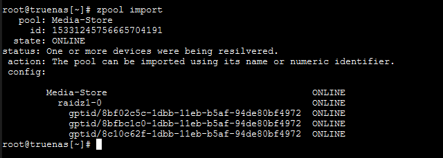

The pool seems to be in perfect working order apart from showing a re-silver error. (see below)
I downloaded and installed UFS Explorer thinking that i would need to do data recovery. However UFS can see the drives and the data, but reports that there are no problems with the drives or the pool.
Can anyone suggest a way to get the pool and data back without having to use the UFS recovery tool

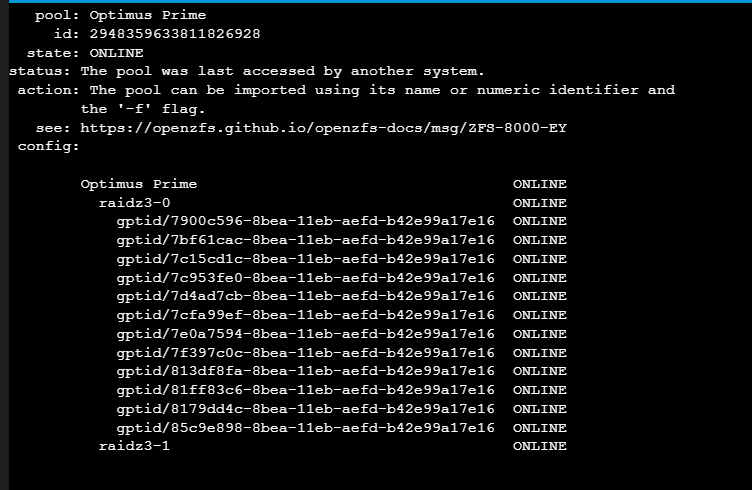

with zpool import i get this
so it doesn't look like it was resilvering or anything.
I used zpool import -R /mnt -f -o readonly=on 2948359633811826928 to see if I could get it to mount and it does. I can SSH into the box and see all my data the only thing that doesn't show up is the zvol on that pool for my cameras. I guess I figured out that caused the problem.
Is there a way to delete that ZVOL so it can be imported. otherwise i'll be going to get drives

I don't know why the camera zvol would cause problems. I would be interested to see if anyone else experiences this problem with ECC. That would tend to indicate there is a bug rather than an unfortunate sequence of events.
In the meantime, glad to hear the data is salvageable....
The only thing I can think is a bit flipped when it was recording footage from my security cameras because that zvol was connected to a windows VM. I'm looking into ECC ram for this machine thank god for AMD having the capability across the platform. Also working on a custom front for my server case "Rosewill RSV-L4412" so I can water cool this CPU a bit better.
