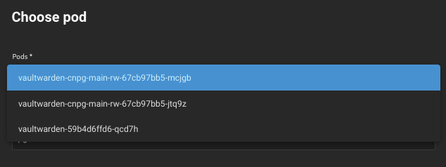

When I start the App via GUI I get this:
sudo k3s kubectl get pods -n ix-vaultwarden
NAME                                       READY   STATUS             RESTARTS         AGE
vaultwarden-cnpg-main-rw-67cb97bb5-mcjgb   1/1     Running            0                22h
vaultwarden-cnpg-main-rw-67cb97bb5-jtq9z   1/1     Running            0                22h
vaultwarden-59b4d6ffd6-qcd7h               0/1     CrashLoopBackOff   32 (2m12s ago)   148m

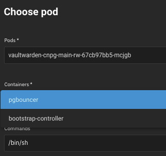

vaultwarden-cnpg-main-rw-67cb97bb5-mcjgb is the pgbouncer pod appears twice, because I set it to 2 replications.

So for now the pgbouncer of the original installation cannot connect to the postgresql database as it is not loading anymore. From what I see it should have two PODs with this naming schema: "vaultwarden-cnpg-main-[1,2]". In these PODs I should be able to open the shell within it with the postgres user. Within the "vaultwarden-cnpg-main-rw" PODs I can only open the shell with the so called pgbouncer user:

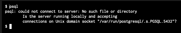

If I now want to get into psql, I get this:
what seems logical to me, as there is no psql instance started for this app.
