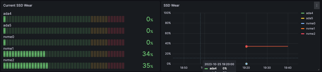

HI all, but specifically iX, so I'm tagging @morganL ...
What are the plans about reporting to an external system for the upcoming CORE 13.1? Will the collectd based graphite plain text reporting be removed as it was in SCALE, too?
Reason: I just wrote a nice little script to report the wear level of all your SSDs via graphite --> influx --> grafana, and would of course love to post the details here. But if graphite reporting is going away, anyway, there is not much of a point.
Thanks!

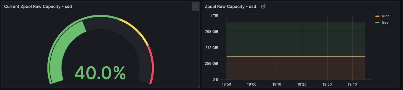

BTW ... I also push the current Zpool usage into Grafana. That's the beauty of the graphite plain text protocol. It's trivially scriptable:
