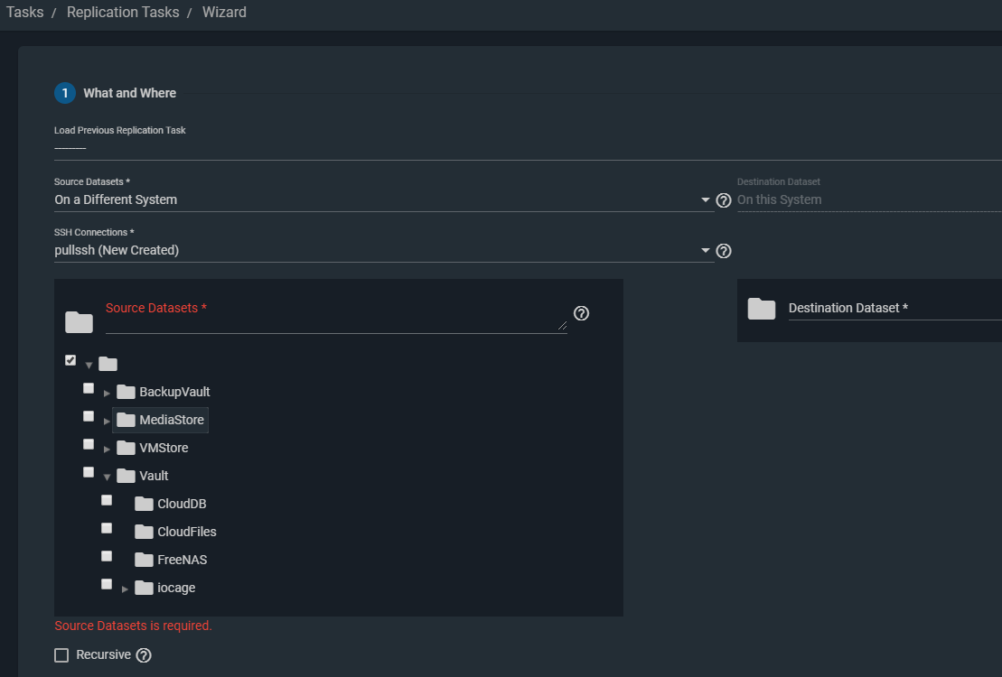

So in terms of using zfs/FN replication in a PULL setup vs a push, is this something i would have to script and/or do via the cli (and cron)? im asking as i don't see a way to do a PULL setup via the FN GUI.
It is in the 11.3 tree
SMnasMAN
Dec 2, 2018
177
Holy @$&%Y!! that is awesome! thanks blueether (and ixsys!) I dont mess with the RC / Test builds much, so was unaware this is an upcoming new feature on 11.3! so thanks! (i did read through the entire new items on for 11.3 on jira, but i must have missed this one)
