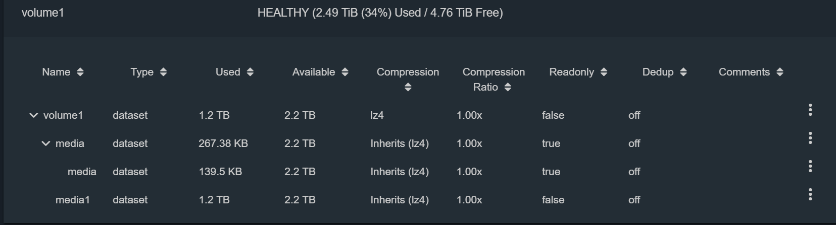

I was able to successfully replicate my data from my old/current FreeNAS box to the new one, however I'm not sure how to restore the snapshot to make the data available at this point. I had replication set to volume1\media and then cloned it to media1 as I didn't know what I was doing. Currently I'd like to get it back to just volume1\media and have the data restored/available from there. I cannot delete the sub dataset of \volume1\media\media, I also cannot clone the snapshot back to the other dataset as I get an already exists error. Any help would be much appreciated.

Hey Linedpaper,
You got it right : To make the data available in the second NAS, you need to clone the dataset / snapshot you wish exactly the way you did. Once done with that clone, you can just delete it as easily as you created it. As it is called, it is a clone, not the original. Destroying the clone will not touch the original in anyway.
