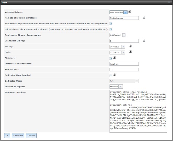

Hello,
i try to set up an automatic replication task for my Jails. I want to save them on the same maschine in another pool. I have set an automatic snapshot vor my JailsRoot and i set the pulic key in from the replication window in root user.
my Jail Direktory is: /mnt/pool_jails/jails
my remote directory is: /mnt/Media/Backup
Attached find my Replication Setting.. but i dont know what i have to set in remote key: Depands on the manual i shoult use th SSH Key Scan Button to retrieve the remote key but ... i cant find this button... :(
This is the error i get:
KRITISCH: Replication pool_jails/jails -> localhost:Media/Backup failed: Failed: pool_jails/jails/.warden-template-standard (clean)
Hope anyone can help to solve this problem :)
Thank you!

Sorry if I'm missing something, but I can't see the attached file. It would be useful to check your settings.
ArgaWoW
Jul 4, 2015
444
rogerh
Apr 18, 2014
1,111
Here is the link to the ticket and the picture of my settings for the task:
https://bugs.freenas.org/issues/11230
I hope this will help to solve my problem :)
