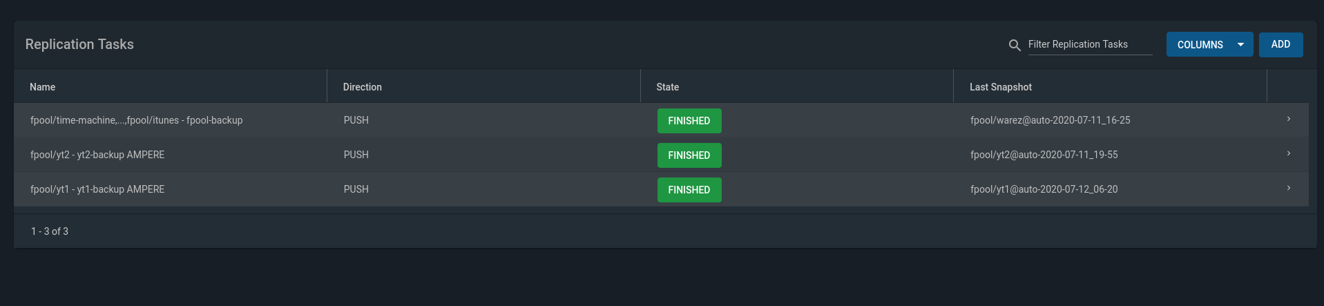

I finally got the replication going. Thanks so much! I probably suffered from the common misapprehension that you mentioned
earlier, stubbornly using ssh-copy-id of the root folder. Copying the public SSH Keypair enabled browsing on the GhostBSD computer!!
Problem SOLVED!
