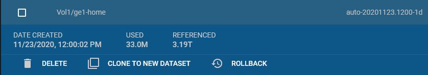

Here's the Snapshot:

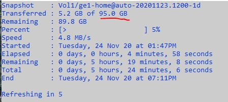

Here's the Replication Task running :

I just don't get it ... Command line "zfs list -o space -r Vol1" list all snapshot and even if it should send all of them, the total is less the 1GB.
Vol1/ge1-home@auto-20201123.1200-1d - 33.0M - - - -
Vol1/ge1-home@auto-20201123.1300-1d - 15.3M - - - -
Vol1/ge1-home@auto-20201123.1400-1d - 42.7M - - - -
Vol1/ge1-home@auto-20201123.1500-1d - 44.1M - - - -
Vol1/ge1-home@auto-20201123.1600-1d - 32.8M - - - -
Vol1/ge1-home@auto-20201123.1700-1d - 21.5M - - - -
Vol1/ge1-home@auto-20201123.1800-1d - 61.6M - - - -
Vol1/ge1-home@auto-20201123.2000-1w - 2.51M - - - -
Vol1/ge1-home@auto-20201123.2031-1m - 2.51M - - - -
Vol1/ge1-home@auto-20201124.0800-1d - 41.3M - - - -
Vol1/ge1-home@auto-20201124.0900-1d - 39.2M - - - -
Vol1/ge1-home@auto-20201124.1000-1d - 31.0M - - - -
Vol1/ge1-home@auto-20201124.1100-1d - 58.1M - - - -
Vol1/ge1-home@auto-20201124.1200-1d - 24.0M - - - -
Vol1/ge1-home@auto-20201124.1300-1d - 24.9M - - - -
Vol1/ge1-home@auto-20201124.1400-1d - 25.2M - - - -
Vol1/ge1-home@auto-20201124.1500-1d - 29.2M - - - -
Vol1/ge1-home@auto-20201124.1600-1d - 18.6M - - - -

Even sending all the snapshots for the Dataset ... the total is way beyong 1GB ...
It's sending 95GB !!!
After transfert succeeds ... the snapshot on the remote server is indeed 33MB !

It's difficult to diagnose from here.... 33MB referencing 3.19TB is fairly extreme. Is this what you think is the situation with that dataset?

I may have found something on this...
I suppose that there were some snapshots mismatch (no idea why) and the replication tried to resync with an old common snapshot.
And although the GUI and command line list a specific snapshot with a specific size, it was transfering data way back from that common snapshot... way back, I mean few months ...
How come? I don't know ... we just moved the server to remote location, changed IP/subnet and tried to replicate.
Tks for your help! It does replicate good now, although still day time ... :(

UPDATES :
Upgrade to TrueNas 12u1 on all systems clear replication issues. ;)
