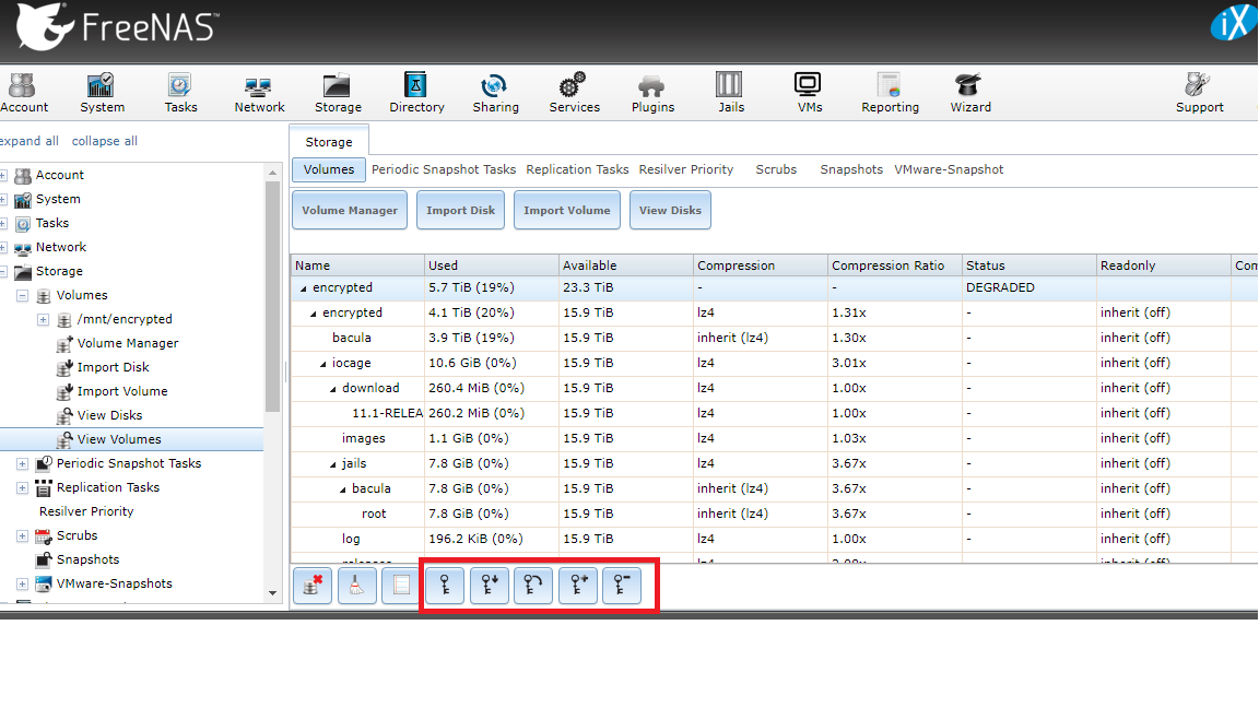

Volume status page has an option to 'download key'. But I assume it's for the Encryption (Geli) key and not Recovery key.
I believe they are both different parameters and there's no option to download Recovery key. PLEASE correct me if I am wrong.
What I meant in my previous post was - we don't have the Recovery key that was configured earlier.
There are five (5) tabs with key icon on volume status page (screenshot attached) which are as follows (from left to right)
1 - Create Passphrase
2 - Download Key
3 - Encryption Re-Key
4 - Add Recovery Key
5 - Remove Recovery Key
Also, when I click on "Replace" disk - it's not asking for a passphrase since passphrase hasn't been configured on the pool.
There is a warning message however that states - "recovery key of the volume will be invalidated” (See Attached)
Based on the description given here - https://www.ixsystems.com/documentation/freenas/11.1/storage.html#managing-encrypted-volumes
I believe the configuration we have is -
  • Key stored locally, no passphrase: the encrypted volume is decrypted and accessible when the system running. Protects “data at rest”only
There is no passphrase since the volume has no lock icon.
But it seems Recovery Key was configured since I am getting the warning above while replacing a disk.

"Donwload key" is indeed going to download the GELI key.
You need to do that.
Encryption-Re-Key generate a new key different from the one currently in use. So when you do, I believe you will be able to save the new Geli Key.
"Add Recovery Key" actually allow you to download the Geli key with the disk GPID. You won't need the Geli key from the above steps, but you will need to know the Passphrase is it is setup.
From my experience, the trouble I have had with encrypted pool during resilvering due to a missing disk, was the absence of a Passphrase.
It would seem if the passphrase was not enabled when resilvering was happening, either at the begining or the end, upon reboot, the newly added disk would not have the correct key and would not be made unavailable.
I don't know if Re-keying would be enough. Most issues related to unavailable disk were the result of an upgrade of the Freenas/FreeBSD release so it is possible the passphrase would not have been required back then.

[2] Can I replace both drives at the same time and then go through #5 to #9 OR Should I replace one disk at a time, wait for resilver to finish and then repeat the process (same steps above) for the second disk?
Replace both disks and re-key as soon as the resilver starts.
psoni
Mar 5, 2019
13
Thanks, is it safe to re-key as soon as resilver starts? I read in the documentation that I have to wait for resilvering to finish before I can re-key. We are on 11.1-U5. Maybe it changed in 11.2?
