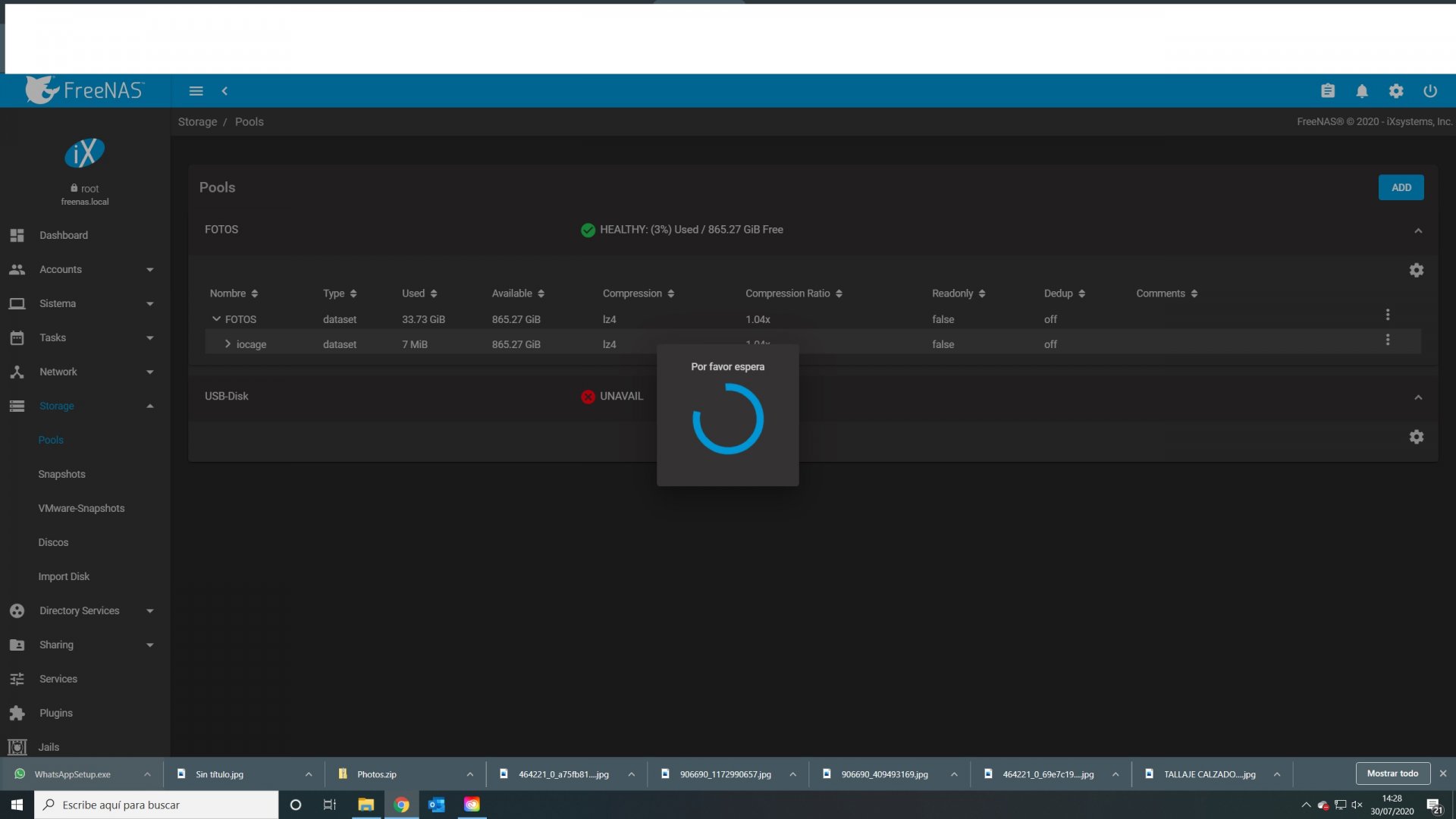

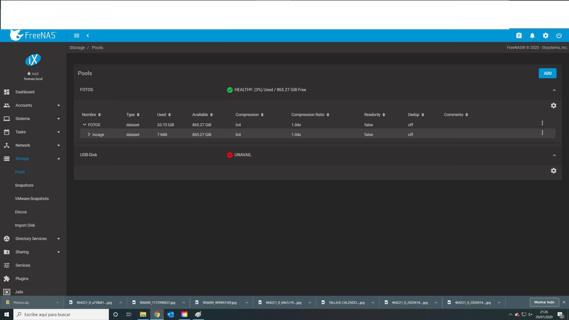

Hello everyone, I need your help to remove a usb pool. It appears to me as Unavail and I cannot install plugins, thanks in advance

Was your jails setup pointing to that pool? You will need to correct that to use a pool that exists under the Jails screen, cogwheel to the far right and select your pool.
Removing the USB pool should be as simple as the cogwheel to the right of that screen and Export/Disconnect.

Hola gracias por tu respuesta
Te paso una captura de pantalla, por lo que permanece cuando intento exportar / disconet

lora3000
Jul 29, 2020
3
Hi, thanks for your response.
I pass you a screenshot, so it stays when I try to export / disconet

9,700
Depending on the options you selected, it may be trying to wipe the drive (which will never work if the drive is gone).
Maybe you didn't even get to the screen to see the options... in that case, maybe running at the shell: zpool clear USB-Disk and then try again.
