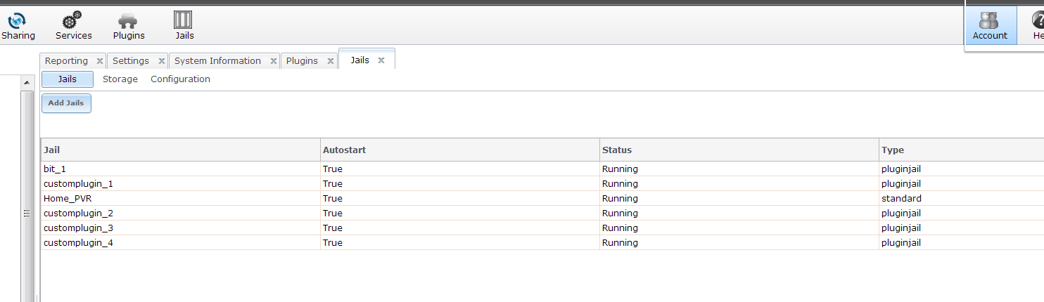

guys I need your help here : i upgraded my freenas from 8.3 to 9.1 and installed the plugins all work correctly except for SB after going to the jail/var/log/message its only have this :
Aug 24 22:15:21 customplugin_4 newsyslog[6856]: logfile first created
Aug 24 22:15:21 customplugin_4 syslogd: kernel boot file is /boot/kernel/kernel
Aug 24 22:15:21 customplugin_4 su: setpriority 'root' (root): Permission denied
the strange thing is that in jails overview its says my jail is running
please i tried everything i know any help is very welcome.
