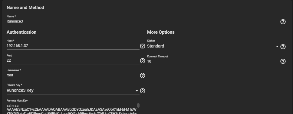

Attaching a screenshot of the Music source machines SSH connection. But the reinstalled target machine does not have this under SSH Connections.

chuck32
Jan 14, 2023
623
Setup according to documentation, the target machine needs the corresponding public key.

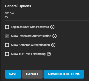

It says in the SSH documentation you posted above that "You must also configure the remote system to allow root access with SSH". Should I tick the first box (under Services -> SSH?
