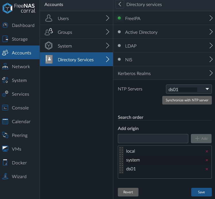

Red Hat Identity (FreeIPA) and Samba working in TrueNAS - what is the status and is it possible?
Howard Swope
Nov 19, 2015
26
This worked great on FreeNas 10. I still haven't upgraded for this reason. I sure wish this would be given a real seat at the table. But the powers that be must not care about it. I have followed these threads for last 10 years and there has never been real attention given this except for one guy who was working on the FreeNAS corral project:
I sure wish it still worked this way.
