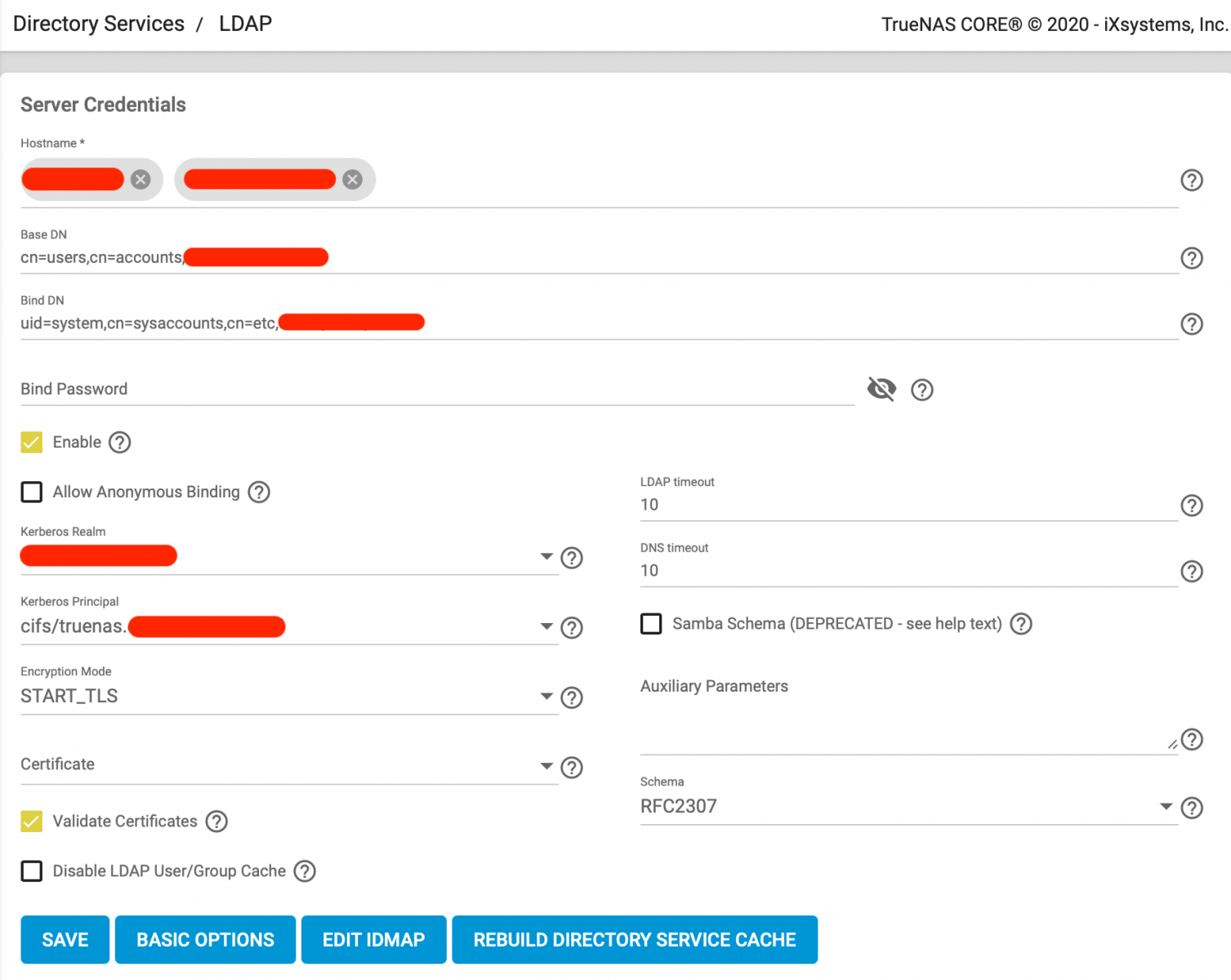

is it possible to get FreeIPA authentication with Samba sharing on TrueNAS 12-U1 ? I've read it was last time working well on FreeNAS 10.
There are hints in JIRA it can be done, but is there a guide maybe?
What works for me:
  • FreeIPA working for years, authenticating users, etc.
  • LDAP configured and working on TrueNAS, I can ssh to TrueNAS box with FreeIPA user, getent works and lists users and groups.
  • ipa-adtrust-install was run on FreeIPA - I needed ipaNTHash attribute for FreeRADIUS authentication - this is working fine.
What doesn't work:

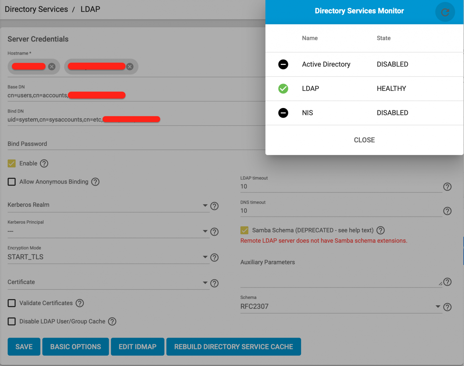

  • Samba sharing with FreeIPA users - if I try to access samba share with FreeIPA user, I see "NT_STATUS_NO_SUCH_USER" error in /var/log/samba4/auth_audit.log
  • Cannot enable "Samba Schema (DEPRECATED - see help text)" - I get a message that "Remote LDAP server does not have Samba schema extensions."
    But do I really need it enabled, particularly since it is "DEPRECATED - see help text" ?
Any hints or help is much appreciated.
Thanks!
shpokas

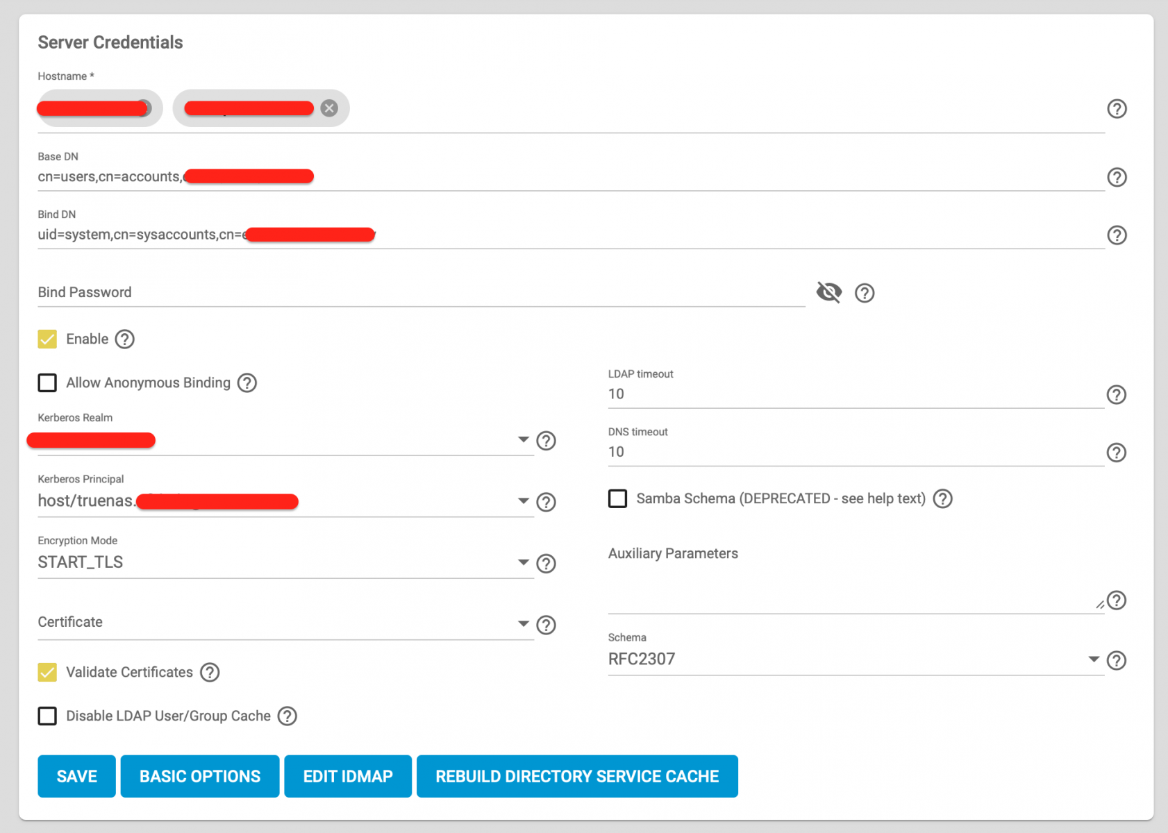

But when I try to add Kerberos part to LDAP configuration, I get an error about invalid credentials or so it says.
Error: Traceback (most recent call last): File "/usr/local/lib/python3.8/site-packages/middlewared/plugins/ldap.py", line 586, in ldap_validate ldap_has_samba_schema = True if (await self.middleware.call('ldap.get_workgroup', data)) else False File "/usr/local/lib/python3.8/site-packages/middlewared/main.py", line 1238, in call return await self._call( File "/usr/local/lib/python3.8/site-packages/middlewared/main.py", line 1195, in _call return await methodobj(*prepared_call.args) File "/usr/local/lib/python3.8/site-packages/middlewared/plugins/ldap.py", line 871, in get_workgroup if len(ret) > 1: TypeError: object of type 'NoneType' has no len() During handling of the above exception, another exception occurred: Traceback (most recent call last): File "/usr/local/lib/python3.8/site-packages/middlewared/main.py", line 137, in call_method result = await self.middleware._call(message['method'], serviceobj, methodobj, params, app=self, File "/usr/local/lib/python3.8/site-packages/middlewared/main.py", line 1195, in _call return await methodobj(*prepared_call.args) File "/usr/local/lib/python3.8/site-packages/middlewared/service.py", line 356, in update rv = await self.middleware._call( File "/usr/local/lib/python3.8/site-packages/middlewared/main.py", line 1195, in _call return await methodobj(*prepared_call.args) File "/usr/local/lib/python3.8/site-packages/middlewared/schema.py", line 973, in nf return await f(*args, **kwargs) File "/usr/local/lib/python3.8/site-packages/middlewared/plugins/ldap.py", line 686, in do_update await self.middleware.call('ldap.ldap_validate', new, verrors) File "/usr/local/lib/python3.8/site-packages/middlewared/main.py", line 1238, in call return await self._call( File "/usr/local/lib/python3.8/site-packages/middlewared/main.py", line 1195, in _call return await methodobj(*prepared_call.args) File "/usr/local/lib/python3.8/site-packages/middlewared/plugins/ldap.py", line 588, in ldap_validate await self.convert_ldap_err_to_verr(data, e, verrors) File "/usr/local/lib/python3.8/site-packages/middlewared/plugins/ldap.py", line 537, in convert_ldap_err_to_verr if e.extra == "INVALID_CREDENTIALS": AttributeError: 'TypeError' object has no attribute 'extra'

Try disabling LDAP service first with the samba schema disabled. Then add your kerberos keytab to the server, then select the principal in the dropdown for LDAP, then enable.
shpokas
Oct 3, 2014
32
You'll also need to configure the kerberos realm for your FreeIPA domain.
I did as told and now I have TrueNAS LDAP directory service enabled with Kerberos attributes.
And the same error as before when I try to connect to Samba share :smile:
Do I need AD also be configured? Because these configuration options you have mentioned I can find only in AD configuration tab:
you have "obey pam restrictions" set, winbind idmap configured for the requisite domain, and client configured to use kerberos authentication for SMB session

Can you PM a debug to look at middleware log regarding traceback? (obey pam restrictions can be an aux parameter for SMB service). You have to correctly configure account / keytab in FreeIPA to provide SMB access (hence mention of having correct Kerberos SPN to provide SMB share access). You can look at Kerberos SPNs generated for computer accounts in AD for a template on how to configure your FreeIPA computer account's kerberos keytab.

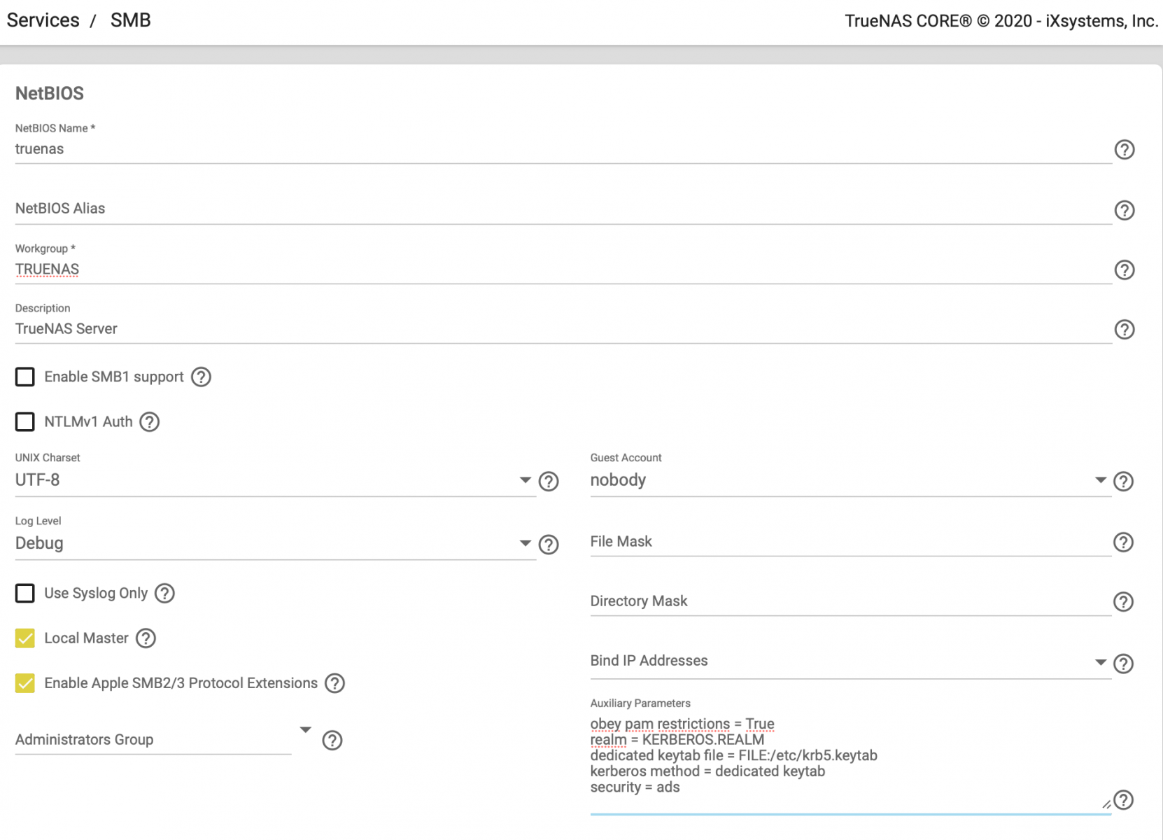

Now I have a working configuration which ½ consists of LDAP+Kerberos and the other ½ is Samba manual configuration from here.
Two screenshots to describe.
I can authenticate to Samba share with FreeIPA user, read and write files.
How stable is it and would it survive any TrueNAS updates? ¯\_(ツ)_/¯

You're basically relying on pam_krb5 for auth. It's pretty stable. I don't expect the samba / pam integration to change any in the near term. Middleware component is using kerberos / GSSAPI for authentication so nothing non-standard here. The steps to get to this place are fiddly though and require some knowledge of underlying protocols and FreeIPA (with most of config happening off the NAS). This is the part that makes it somewhat less easy to have as an officially blessed configuration (compared to AD setup where users just provide a username / password combo and we can automatically take care of almost all config details auto-magically).
