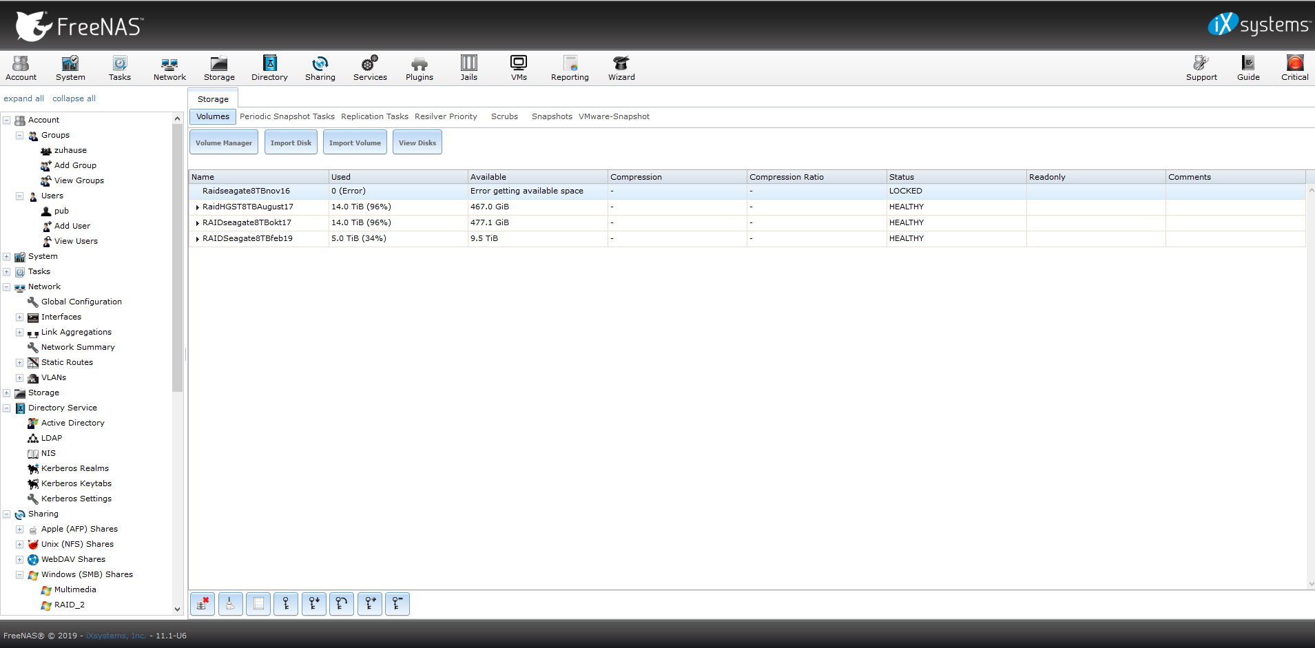

i installed two new drives on my freenas system and wanted to create new Datasets for the drives. I accidently clicked "enhance" of an existing dataset and i run with an error. After that i realised that i made a mistake und created a dataset for the new hard drives.
The new one runs fine but there is my Problem: the old ones are "broken"
The dataset stands there with an "error in calculating of drive capacity" and got a "locked" status.
Is there a way to recover the old datasets with the data on it?

the following txt files contains the content.
The Problem is with the marked raid array on the image ######16

No idea on how to, or even if it's possible to recover from the error. Do you have backups?
That pool would seem to be encrypted. Either you have the keys or it is lost forever.
