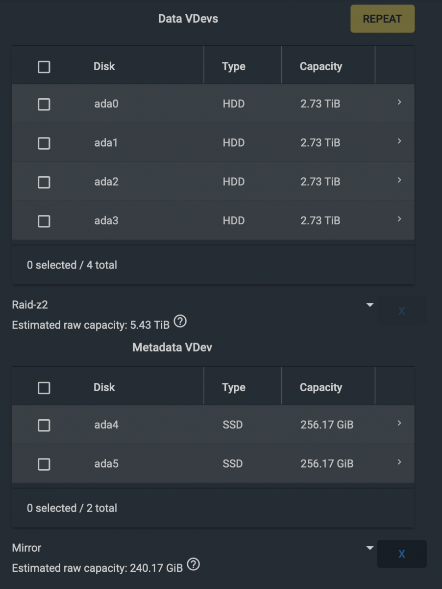

Messing around with the test system I am delighted to find that you can create a fusion pool from the UI:
Plus TrueNAS does the right thing [tm] and creates swap partitions on the disks of the data vdev only ...
Well done, folks, well done!
