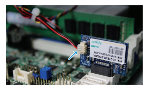

Is there a toggle switch on the DOM putting it in read-only mode?
Redcoat
Feb 18, 2014
2,925
My mini had a separate two-wire power cable directly to the DOM - does yours? If so, is it connected?
