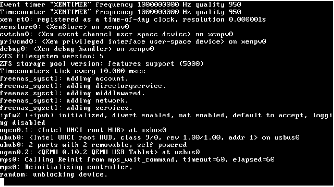

Symptom:
VM reboot gets stuck at "mp0: reinitializing" unless I set "verbose" mode from boot menu (opt 6) or I reboot entire XCP-ng host
Background:
This hardware has been running without issue as a FreeNAS 11.3-U4 guest on XCP-ng 8.1.0. I've completed multiple in place upgrades previously without issue.
No hardware changes, no BIOS changes, no Firmware changes in the environment. Only change in environment was migration to TrueNAS and apply XCP-NG patches.
Installation and first boot to TrueNAS occurred without incident. Attached disks and imported pool without issue. When restoring TrueNAS config, the reboot gets stuck.
Terminal won't get passed "mp0: reinitializing"
VM Boot never progresses no matter how long I wait. Restarting the VM yields the same symptom. If I Reboot XCP-ng host it resolves the issue. A subsequent VM reboot gets stuck again. Strangely, one work around I stumbled upon was to set "verbose" option from boot menu. Most of the time I can get it to boot without rebooting the XCP-ng host. Subsequent VM reboots get stuck again.

Update: Over the holidays I did a fresh install of XCP-NG 8.1 and confirmed FreeNAS 11.3-u5 --> TrueNAS 12.0-U1 all appear to work as designed.
Same hardware, same configuration. Fresh install of XCP-NG 8.2 and the problem is reproduced on multiple versions on FreeNAS / TrueNAS.
This problem appears to be related to an XCP-NG update.
A search in the XCP-NG forums got a similar hit and is still underinvestigation. Added link for reference for anyone encountering this issue
CreeMichaud
Dec 21, 2020
4
Update: There is a kernel patch on XCP-NG 8.2 that seems to have caused this behaviour. The XCP-NG dev team provided a kernel with the patch removed that is a verified working solution. A ticket was opened with Xen Project for an official fix. If you are running TrueNAS Core 12+ in a VM on XCP-NG 8.2 with a SAS or NIC passed through to VM, please follow the forum link above for your work around.
