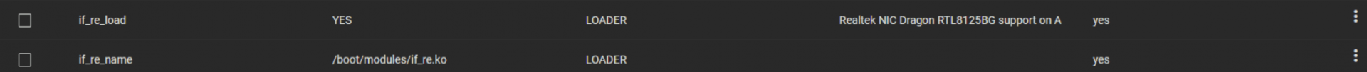

I got a Realtek Dragon RTL8125BG working on TrueNAS-13.0-U3.1 by adding Tunables :
The issue isn't making it work, but rather making it work well, which alas isn't possible.
