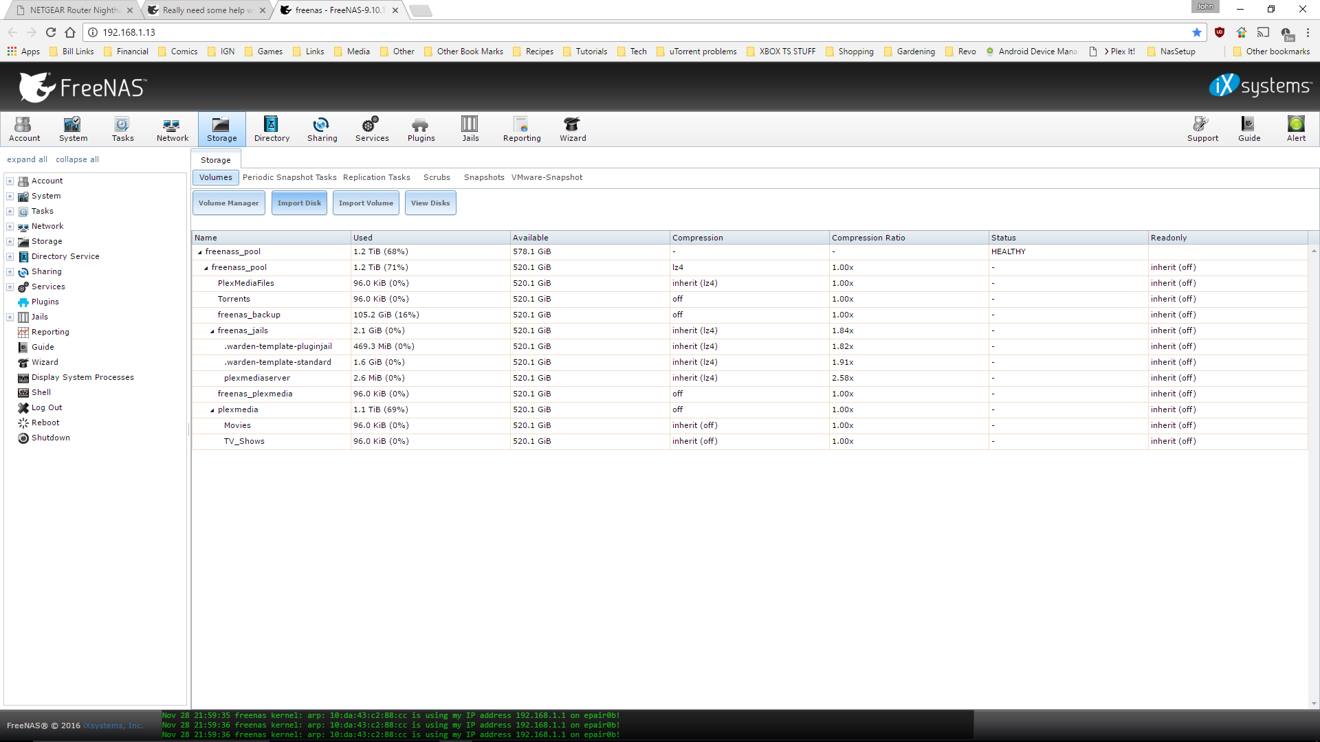

JohnnyDangerX2
Sep 17, 2016
16
Here is my datasets. If I should be showing a different screen, please let me know. If it looks messy or unorganized, thats because it probably is. This is my first attempt at FreeNAS and didnt really know what I was doing going in and was trying to learn as I went along. Anyhow, heres a screenshot. Oh and good news is my wife reminded me that a couple of weeks ago I backed up all my data to an external hard drive I have. So although I want to know how to be able to see the files I have on FreeNAS drive already, if worse comes to worse and I have to wipe everything on the drive, then I should at leasdt be able to get most of my stuff off my other hard drive.

pirateghost
Unintelligible Geek
Feb 29, 2012
4,219
Here is my datasets. If I should be showing a different screen, please let me know. If it looks messy or unorganized, thats because it probably is. This is my first attempt at FreeNAS and didnt really know what I was doing going in and was trying to learn as I went along. Anyhow, heres a screenshot. View attachment 14742
Looks like you created directories in plexmedia dataset, and then created datasets inside with the same name. That's your problem. Your files are in the root of that dataset, and not in the child datasets
JohnnyDangerX2
Sep 17, 2016
16
Should I just remove the datasets with the same name? I just made a mess of things and would rather not lose everything from the drive and have to transfer it all back if I can avoid it. Could you tell me what datasets should be destroyed?

pirateghost
Unintelligible Geek
Feb 29, 2012
4,219
It would appear you need to remove the 2 child datasets from the plexmedia dataset.

JohnnyDangerX2
Sep 17, 2016
16
Your configuration begs the question, what the hell are you doing with only one disk?
Thank you so much, that worked. I cant thank you enough. I know it should have been obvious, but like I said, Im new to this. Now to get a few extra drives to create some redundancy.
