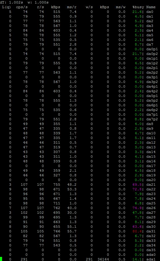

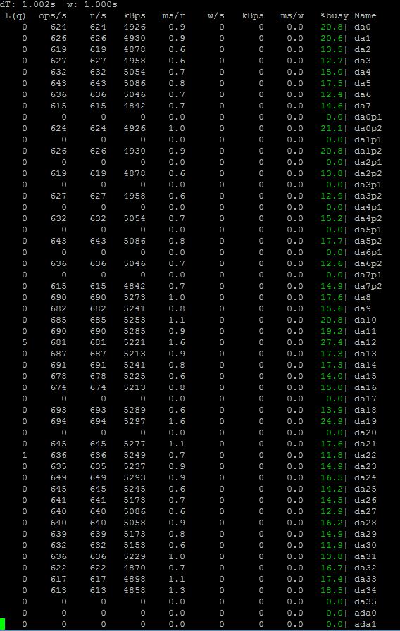

Hey everybody! So ive been having some problems with read speeds when running a verification job (100% read) from a Commvault backup system. Read speeds on the job will be an acceptable ~170MB/sec for about 30-45 minutes and then something i can't figure out happens.. speeds drop to around ~20MB/sec.
Checking out gstat, drive usage is optimal and then when the speeds tank i get drives that have a very high MS/R, killing performance. Its completely random which drives they are, and how many it consists of.. sometimes its 4.. sometimes 6, the only thing i have noticed is they tend to be in the same vdev. Stopping all services that cause disk activity returns the read speeds to normal.. again for about 30-45 minutes.

Has anyone else had problems with drives "choking" after prolonged reads? I've attached screenshots of gstat running 10 minutes in, and what happens after 30-45 minutes.

That sounds like a very close description to what happens on a highly fragmented iSCSI datastore. You're probably blowing through whatever happened to be in ARC/L2ARC (gives great speeds) and then you get to a point where you're no longer hitting ARC *and* you're reading stuff that's not contiguous on disk, so MS/R explodes and life sucks.
The most practical way to address this is to maintain a larger free space reserve on the pool. This allows ZFS to do a better job of allocating contiguous runs of blocks. At 60% full, your iSCSI pool is as full as an iSCSI pool ever should be, and fragmentation will be killing you as writes occur. This has been discussed endlessly on the forum.
