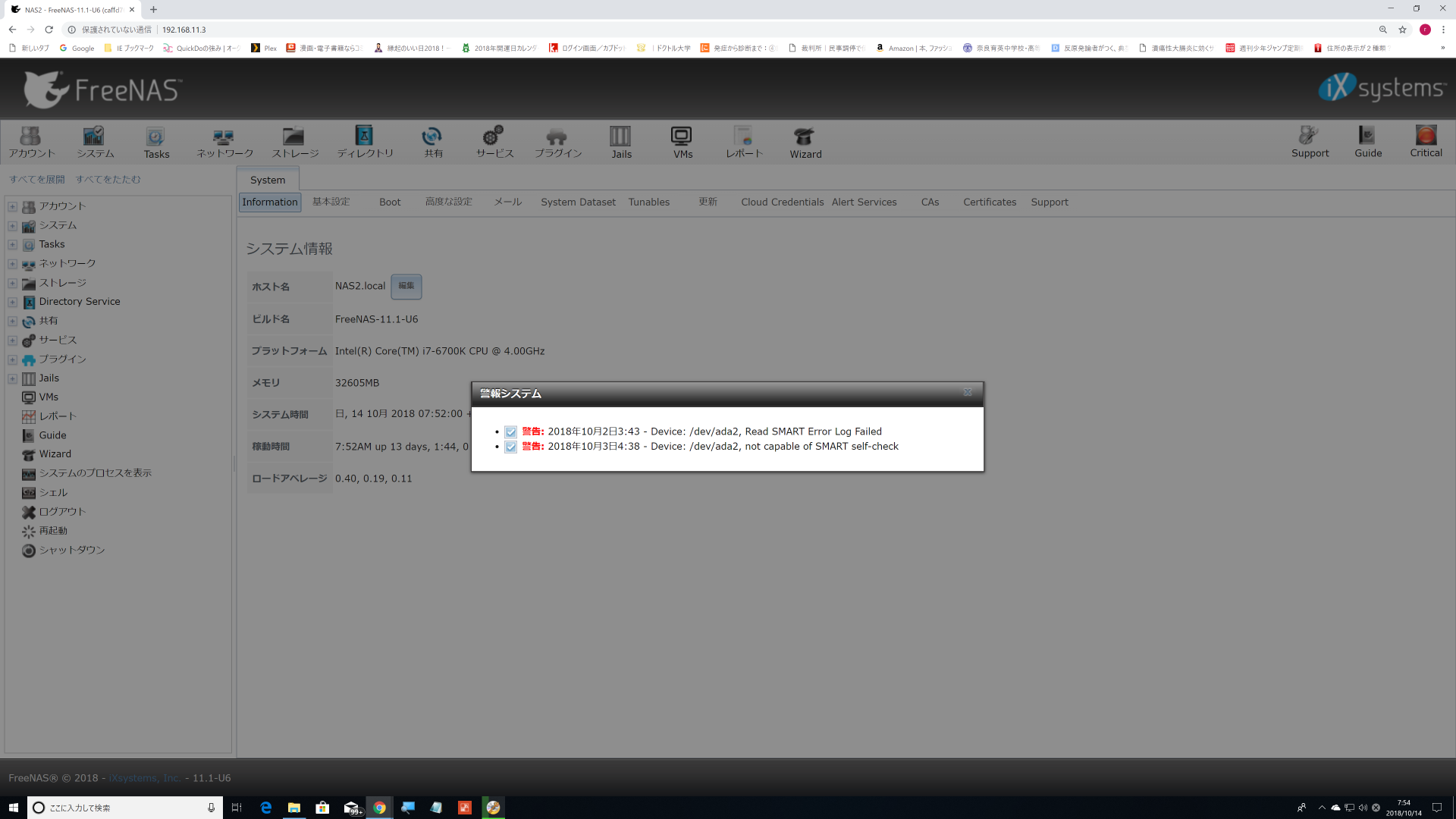

Read SMART Error Log Failed & not capable of SMART self-check
taizo yoshdia
Mar 7, 2017
23
help me please
Please give details on how to deal with the command

taizo yoshdia
Mar 7, 2017
23
HDD:10T*5
ada2 error

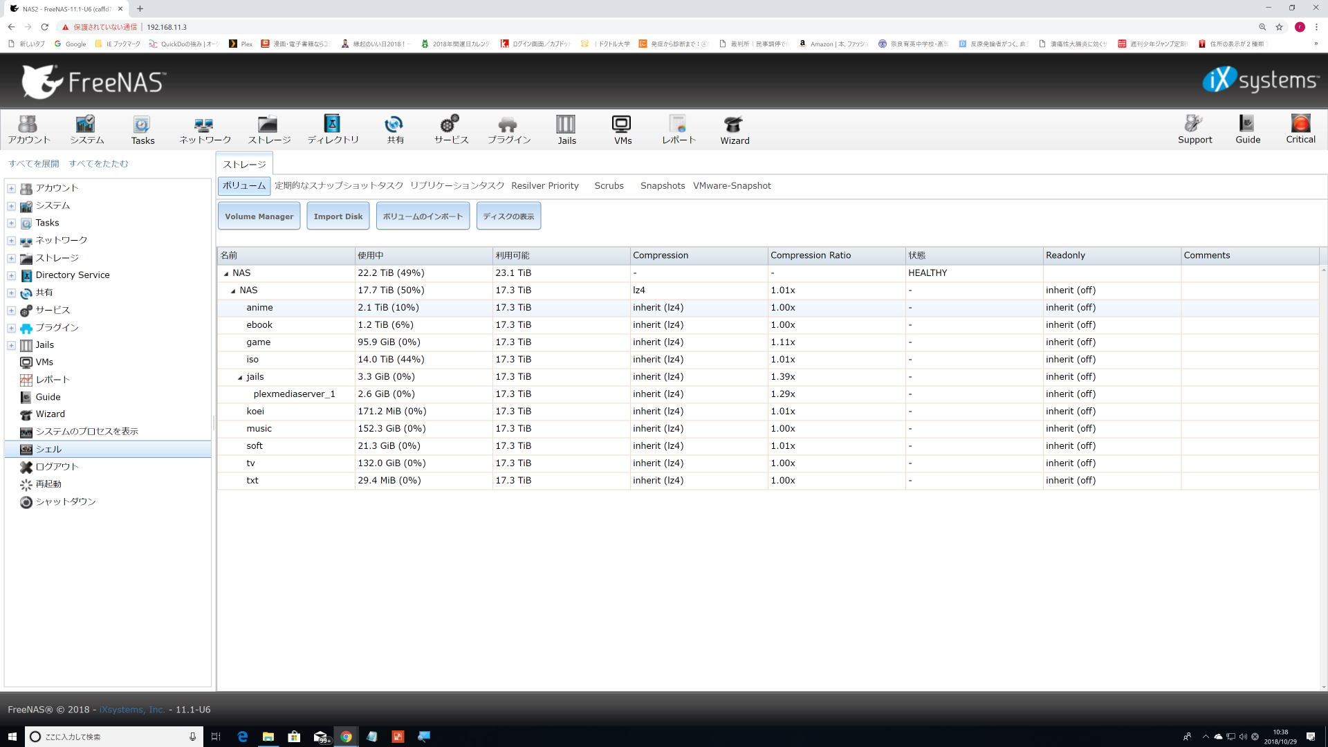

taizo yoshdia
Mar 7, 2017
23
It may be because it was after I checked with SeaTools Bootable, but since warning disappeared, thank you.
I do smartctl -x /dev/ada2
taizo yoshdia
Mar 7, 2017
23
Again error
I want to create smart.txt in the txt directory and see it on windows
how to do ?

MorkaiTheWolf
Aug 8, 2018
32
We still need more details on your build. I see you mentioned that you're using 10TB Seagate Ironwolf drives but what kind of motherboard? Are you using an HBA (host bus adapter) to connect the drives?
A full printout of the your system would be very helpful.
Chris Moore
May 2, 2015
10,079
I do not know well because the shell does not scroll I got a warning.
You need to setup a method to connect to your system by SSH. Also, when you post long text listings, put it in code tags like this:
