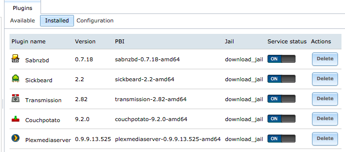

I'm just curious what's a better way to consistently update the plugins when I have them all in 1 jail. I appreciate your hard work on your apps that you've built, as I use them. As well as the guide you made as I used it and it works very well.Mostly sabnzbd and plex. In FreeNAS Installed Plugins, none of my plugins have the update button when I know there are more up to date versions from download.freenas.org. Is there a way to check the version of the plugins via ssh and see if they are different than what is showing in the plugins section of FreeNAS?
For Plex alot of people like using PMS_Updater script to update Plex. But, if you install or update to the latest version of the Plex plugin I made a change that should make plugin updates much faster and more reliable.
You can decide what's better. Either should work.
For sabnzbd and plex the versions should be shown on the Plugins > Installed tab.
You're not being presented with the update button for these two plugins? Can you provide a screenshot?
I've ran that script before and I thought it worked, however, when i access the plex GUI it says I need to update manually.
