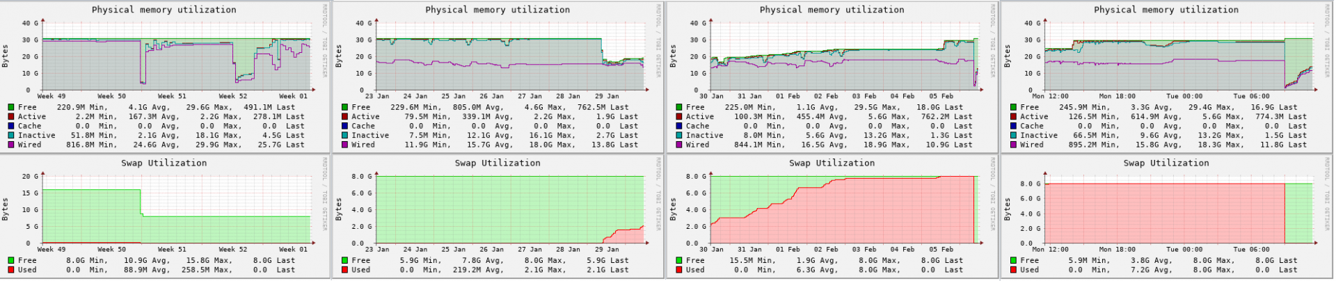

Looking at the reports (see images below which I've tried to show in chronological order) I saw that the system had run out of RAM (32Gb) so had overflown into the pagefile. I rebooted the system this morning and the RAM usage returned to more normal levels however it does seem to be slowly creeping up and is already at c16Gb (slightly higher than I would expect assuming 1Gb per 1Tb rule of thumb and with the system containing c8Tb of files).
Looking this with my inexperienced eye, a few things of note stick out.
1) The pagefile size decreased about the time that I migrated from FreeNAS 9 to 11 - dont think this is relevant
2) Historically my memory usage has been c100%, is this normal??
3) Sometime around the 29th of Jan the graph shows my total memory available dropping to c18Gb - presume just a GUI reporting error however at the same time the pagefile started being used. Over the next week the total memory available increased back to 32Gb but the pagefile increased to 100% at the same time.
Has anyone experienced something similar, is it a memory leak? My main concerns are
a) memory usage being so high when I only have 8Tb of files so expecting c8Gb of usage (I thought I had over provisioned with 32Gb - do I need more?)
b) that I didn't notice the system ticking over into the page file and then running at 100% - is there an easy way of tracking this using the daily reports?

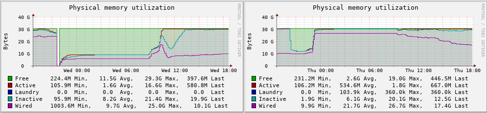

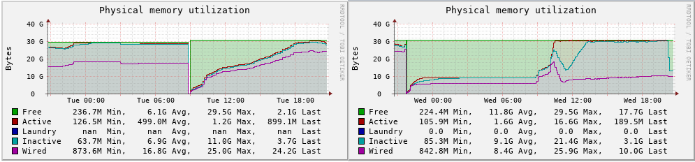

Hi guys, updated last night and let a day of usual activity to occur and it seems to have fixed the problem, as per the image below which shows yesterday vs today "wired / kernel" memory is staying at a much more reasonable level through peak usage.
Thanks for the help!
Hugh

Why is there such a large amount of inactive memory on Wednesday? (which is presumably after you upgraded.)

Hi toadman,
Mid point of the left graph (tues morning) was when I rebooted under 11-stable. Left of the right graph is when I upgraded to 11-U1 (tues evening) and rebooted again. Overnight no users were using the system causing the flat usage up to the mid point of the right graph at which point everyone starts using it (around 30 users) and the snapshots are run hourly causing the RAM spike from c8am to c6pm.
With my limited knowledge of FreeNAS I think the old information is stored in the RAM on the off chance it might be requested again. When the server stopped being used it looks like the system has cleared the inactive RAM into free RAM (you can see the drop at the rightmost end of the right graph).
Interestingly enough over the last two hours i have seen the Wired / kernel RAM allocation gradually ticking up 10% for no reason I can discern so will keep monitoring and feedback if anything further anomalous happens.
Thanks
toadman
Jun 4, 2013
619
given that the ARC is included in "Wired" I would have expected the ramp of Wired to look like it did on the left. i.e. as the ARC fills up Wired ramps up to a large percentage of the total. Inactive memory is just sitting around doing nothing, so you don't want large amounts of it. Maybe the ARC just hasn't warmed up yet.
I don't think the ARC evicts things unless it has to do so, so I would expect the ARC to keep live data as Wired, not release large amounts to inactive. I could be wrong. So if you continue to see high amounts of Inactive memory (as a percentage of the system) then something else may be amiss. For example, on my 16GB system my inactive memory amount is typically below 1GB total.
toadman
Jun 4, 2013
619
i.e I think it should look more like your week 49-50 in the original graphs.
HughT
Nov 21, 2017
10
Ah, I wasn't aware ARC sat there (I actually thought it was in inactive, clearly I still have some reading up to do!).
Wired usage did eventually tick up but it was actually overnight when the backups are run, then though the day it's been slowly ticking down, odd...
As an aside I did get another "mpr0: Out of chain frames, consider increasing hw.mpr.max_chains." from the daily log but apart from that the system seems okay.
