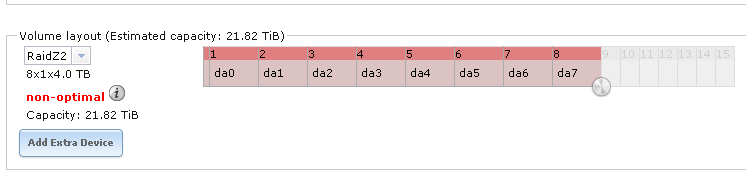

Thanks for the input, :) about how much longer is the time difference between between RAIDZ1 and RAIDZ2 when rebuilding? Another question if we decide to go with RaidZ2 is the performance going to decline noticeably if we set the layout pictured in the attached file? At night we plan to run out exchange backup to freenas, the users documents we plan to house on here are mostly just word and excel documents so we are not to concerned about performance in that area.

After reading up on Raid and RaidZ I came across some articles describing how a Raid5/Raidz rebuild can become corrupt due to bad sectors on the remaining drives (same one posted above). And since 2009 its been unadvised to use Raid5 (show how long since I had to setup Raid, pretty rusty.) I'm not sure what resilvering is? Thanks for any input, I appreciate it.
