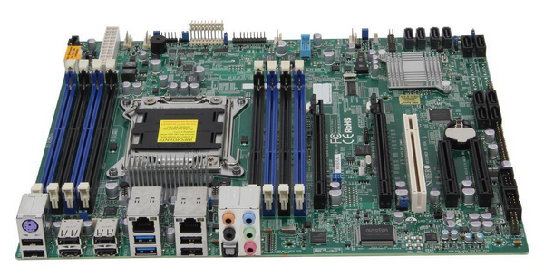

a new Supermicro MBD-X9SRA-B for 220€

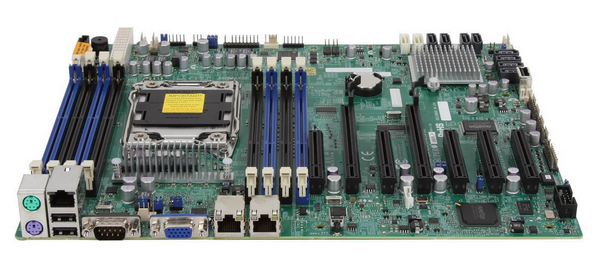

I wouldn't get the X9SRA-B because it doesn't include IPMI. It has Audio instead.
The one you want to get, if you can find it, is the X9SRL-F (the -F means it has IPMI)
The X9SRL-F also has a couple extra PCIe slots, but the big thing is the IPMI.

I had another look on Ebay. Unfortunately there is no X9SRL-F available and I understand the advantages of the IMPI. But as this option is not available I would not mind using the X9SRA-B instead - and it's new. Don't know if the integrated Intel NICs are good, but I do like the external USB 3.0 as I now must have an external USB 3.0 drive for daily backup (due to lost data).

Is there anything else (downside) of the MBD-X9SRA-B apart of hte IPMI?
The X9SRA-B has that silly old 32bit PCI slot (the white one) that isn't good for much of anything and I don't think the board has any video capability built-in, so you would need a video card. It really is a workstation system board for a high-end desktop. Not saying anything bad about it, that is the model board I have in my wife's desktop with a Xeon 1650 v2 CPU @ 3.5GHz. It works like a champ for regular desktop computer chores, but it really isn't optimized for use as a server. It is like using a Ferrari to haul furniture. It might be able to do it, but it really isn't made for it.
https://www.ebay.com/itm/Supermicro...-8C-2-0GHz-w-Heatsink-I-O-Shield/352401605107
