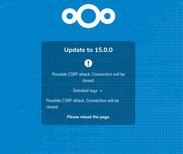

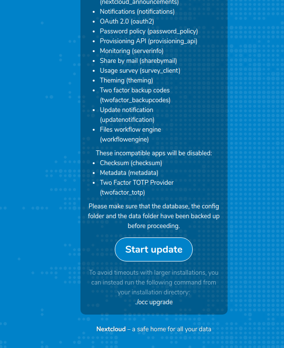

Running Nextcloud 14.0.3 on a FreeNAS-11.2-RELEASE-U1 and did a upgrade via the FreeNAS web-shell to Nextcloud Version 15.0.0.
How I did the update of the Nextcloud jail.
iocage upgrade nextcloud
This worked fine, but now i got stuck in the webupater.
Possible CSRF attack. Connection will be closed.
