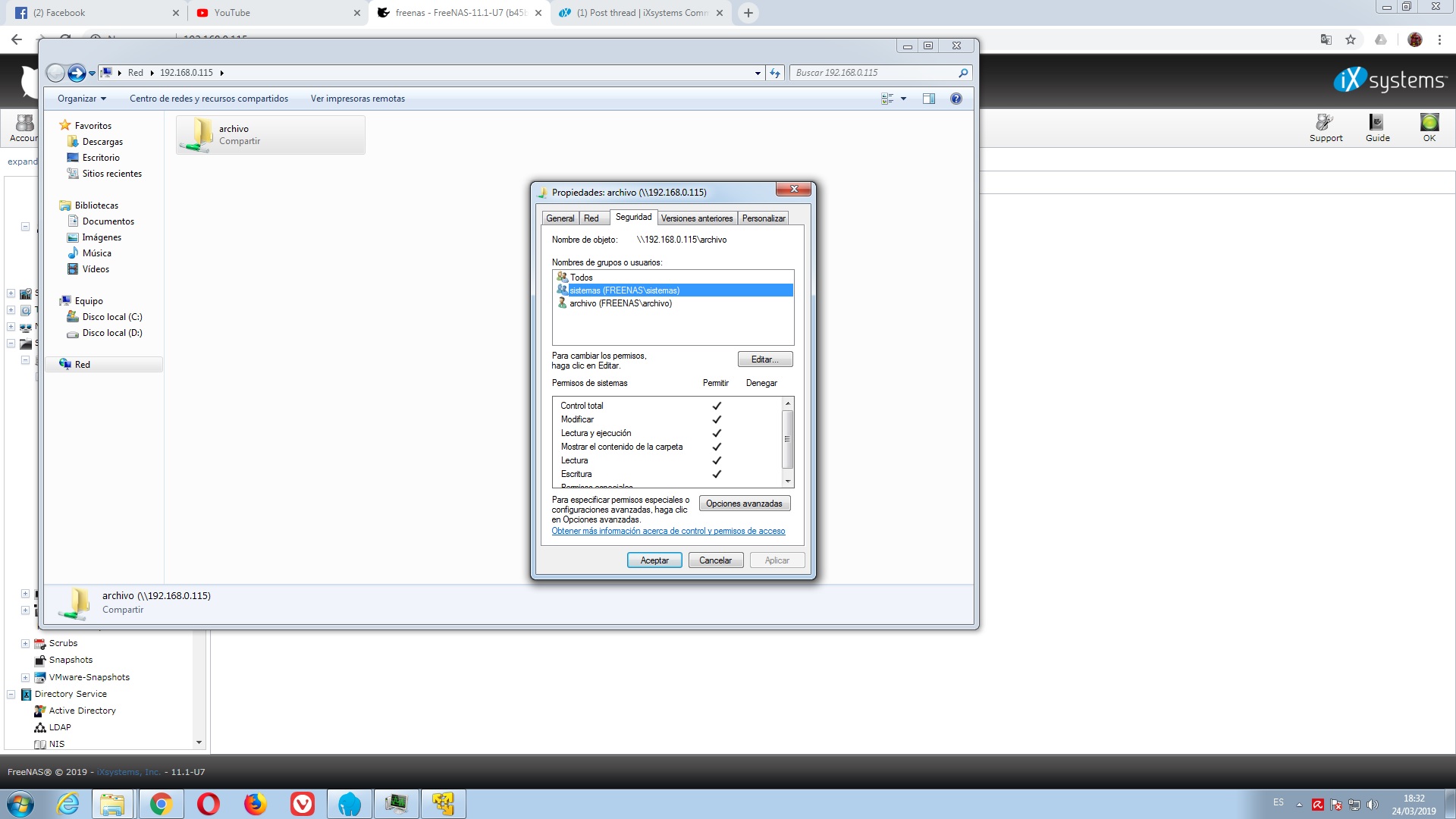

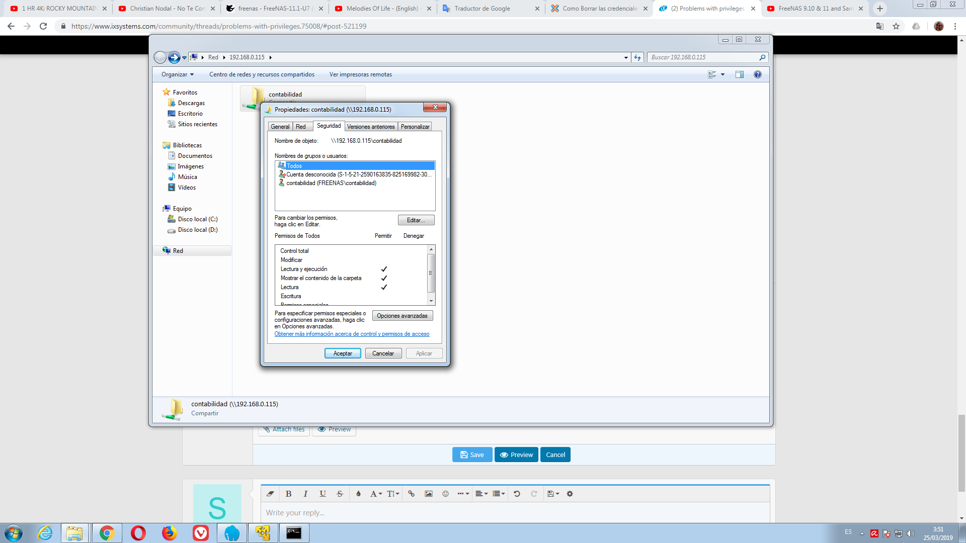

How about, I have a shared folder, which appears with the user file, but the strange thing is that it appears with a user systems, when it has already been erased completely, what can happen?.

What I think you're observing is how Windows interprets the Unix permissions on the dataset.

The strange thing is that the user sistemas I erase it, and it keeps appearing there

You mean the group sistemas? What users do you have assigned on the corresponding dataset? eg.

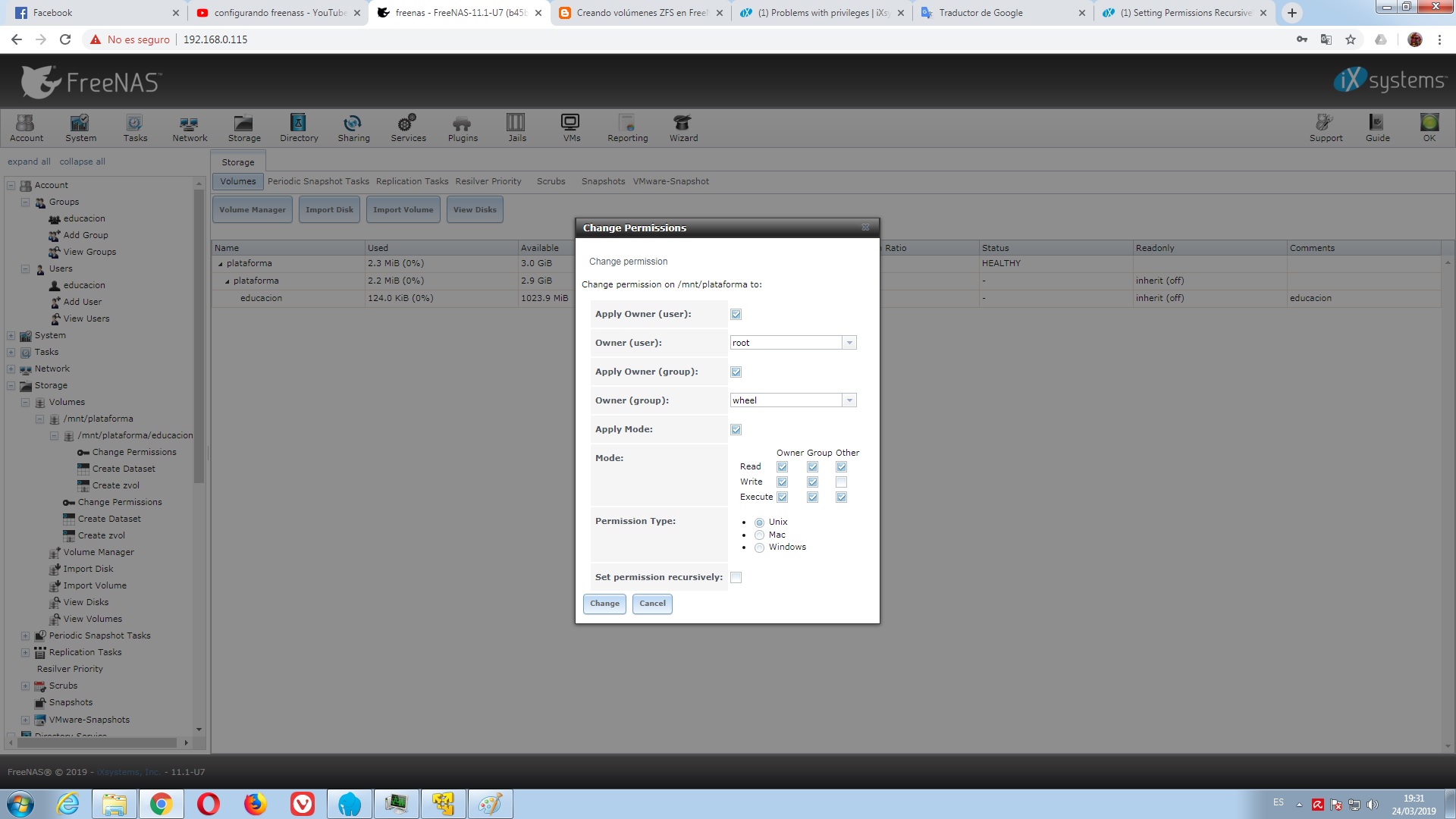

I have it this way, but I wonder, if I need to create the shared folders with window, should I leave the root in unix?

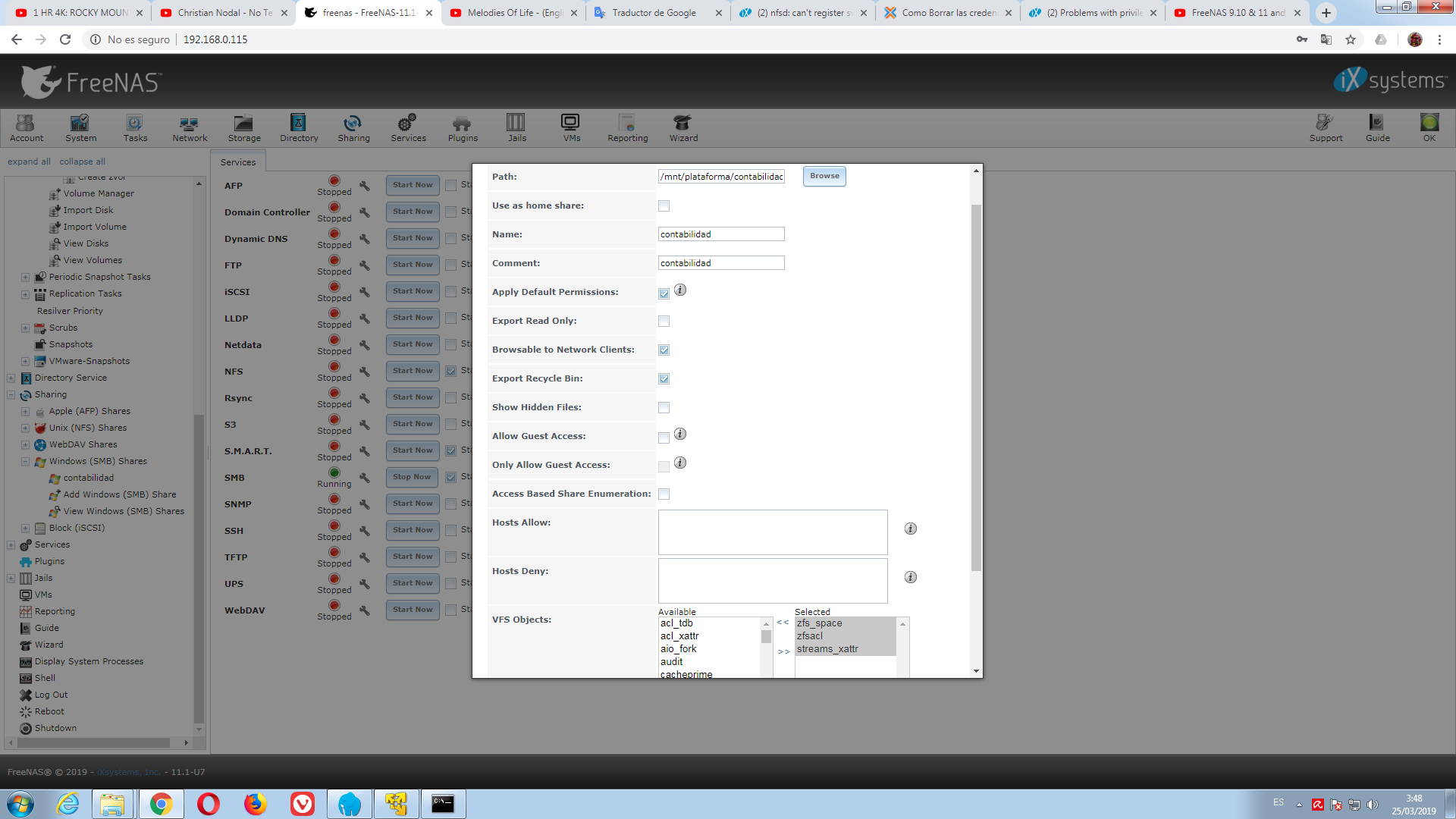

ok look, I'm working in a window 7, my intention that any user within the network lan, either win 7 or win10 can access this shared folder, with user that gave them access, such as user contabilidad, password xxxx, basically so I have my folder configured.

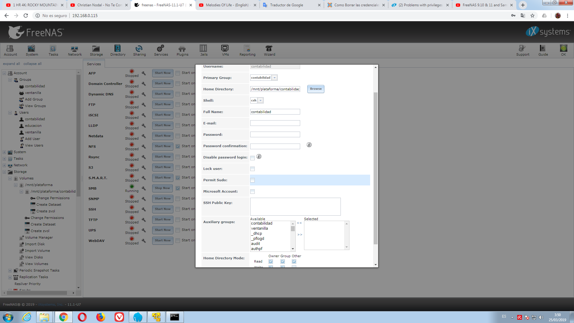

I have this in the storage
and I have this in the user
but when looking at the properties of the shared folder, I see an unknown account, and I do not know why, a valid account should appear.
Maybe I'm missing something to configure? or do something wrong?
You may have a corrupted groupmap. Let's put this to one side for the moment and resolve the permissions issue first.
