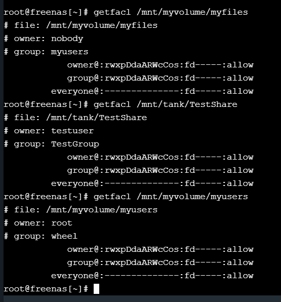

anodos
Sambassador
Mar 6, 2014
9,553
ACLs shouldn't be set on /mnt/myvolume. The current permission set prevents anyone other than members of "myusers" traversing to your shares. Select one share that isn't working and post getfacl output for each path component to it.
markgca
Nov 7, 2019
46
i didnt change the acls, just the owner/group in the freenas web to see what would happen. basically im trying different settings based on many different youtube or ixsystems tutorials since i am totally at a loss here.
the problem is when i click on the freenas icon in the windows network browser, it gives me a login box but wont let me log in.
so i cant even get TO the shares at this point.
but for what i do have here is the output;
and thanks for any help; at this point this is the most expensive boat anchor i have ever had...
