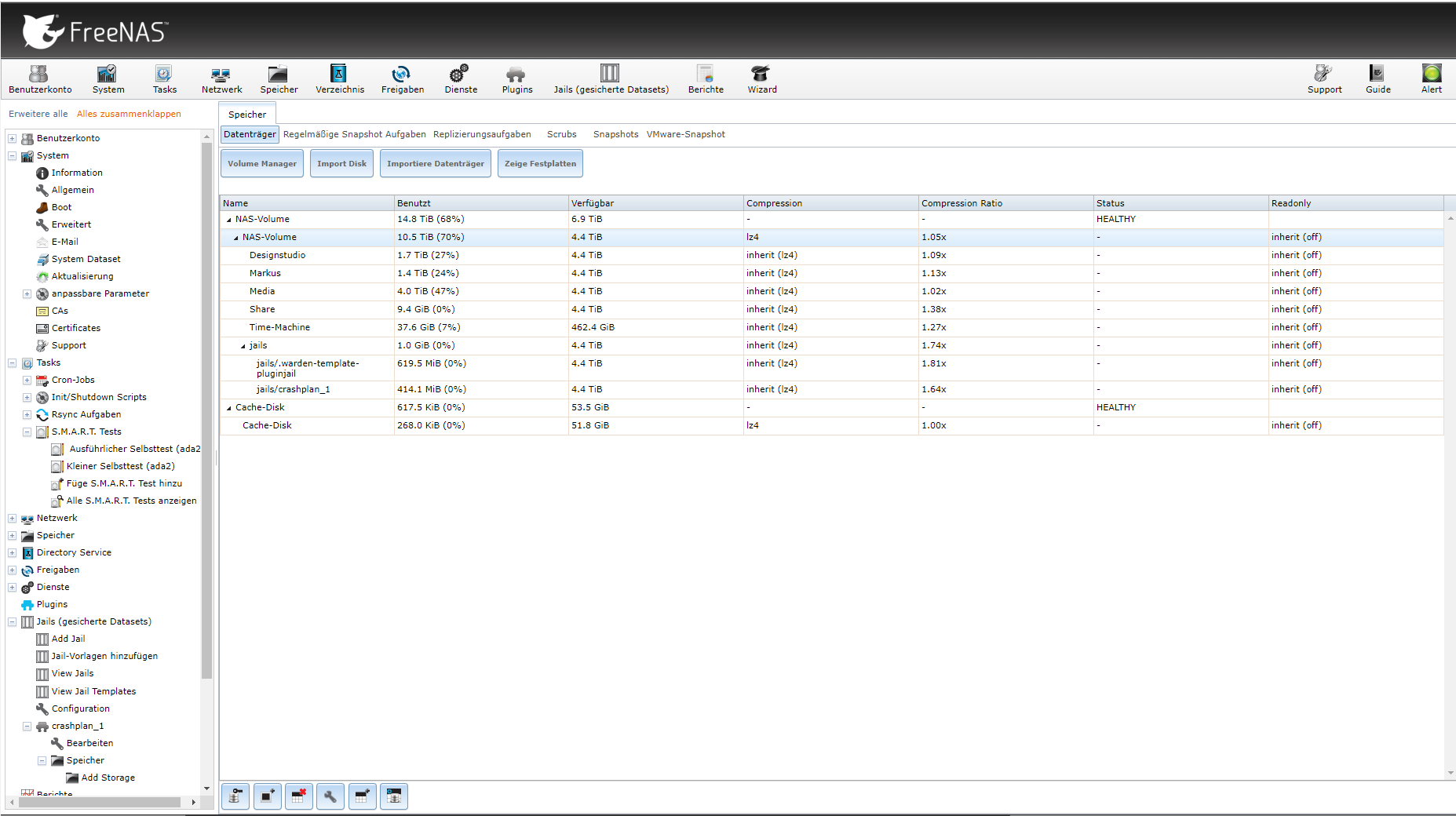

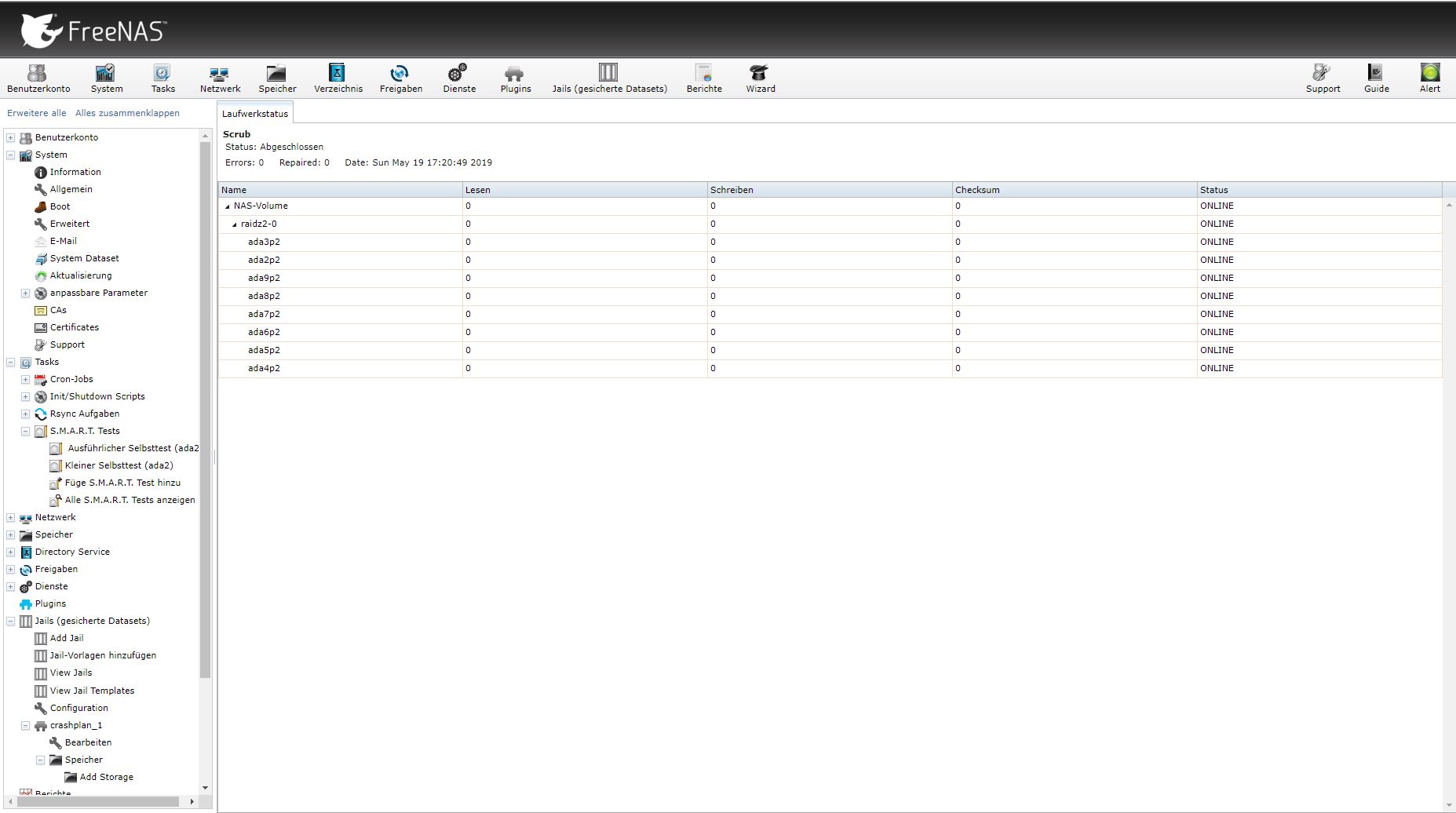

My ZFS status
My disc/ volume setup. All healthy here.
I am a little confused about read / write is all 0 here?
