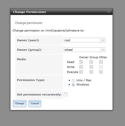

Logging in as root will give you permissions if root ownes the files. Post the owner of the dataset and its permissions also post your cifs settings.

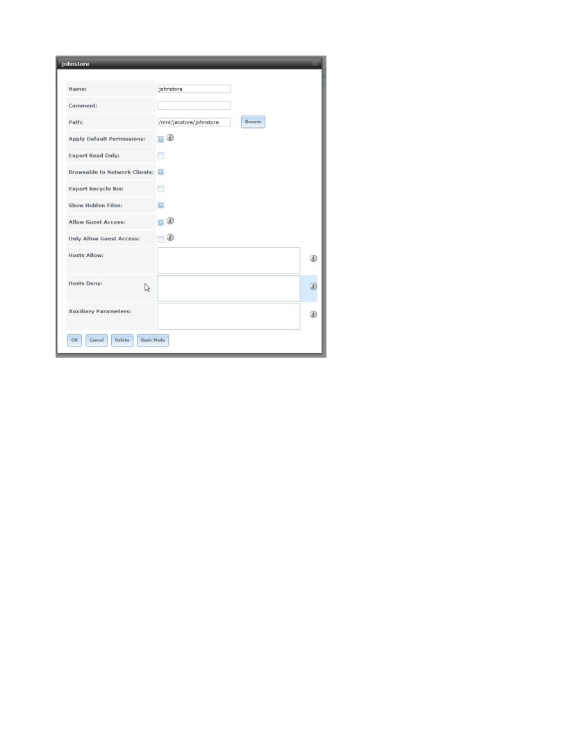

My apologies if I am a little (or a lot) dense at this. I'm sure there is a better way to set things up. The only user that I have created on this is one for my MacBook time machine backups. below are screenshots of what you asked for I think. Thanks.

On the two computers that don't have write access what user are you using? What ever that user is needs to have write permissions granted for their account. You can also right click on the share from Windows and give that user write permissions.

If you are using guest access you need to give your guest cifs user account write access to the share and directories. The guest user can be found under cifs settings. To give permissions you need to modify those from Windows probably. Just right click on the share and go to the security settings.
