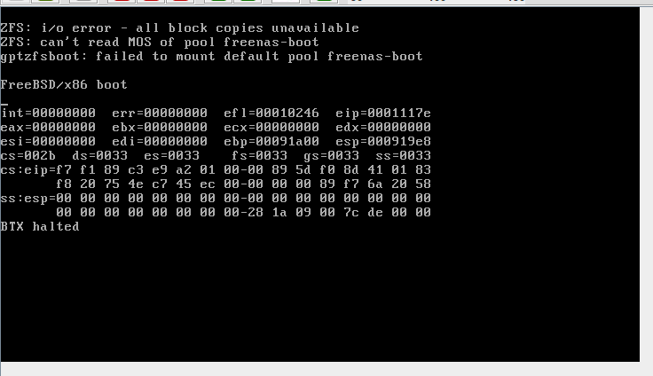

Hello everyone,
I recently experienced a couple power outages and now TrueNAS won't start. I'm greeted with the below message when it boots up.
Does this look like a hardware issue? How do I go about recovering from this?

Corrupt boot media. Reinstall TrueNAS and a backup of your configuration. If you don't have a backup conf, you may be able to recover one from the old system.

A UPS is not strictly required for TrueNAS, and a corrupted boot device can just as easily show up after a controlled power-off.
Your configuration is automatically backed up to the system dataset [1] (which is migrated to your first created pool) - you may be able to recover it from there if you had a complex configuration, but you should be able to reinstall and choose "Import Pool" as a first step.
I had an SSD attached at the time of the outage that won't boot at all, as in, it doesn't post anything, just a blank screen when it's supposed to be loading.
This is when I stick in an old USB boot drive that wasn't plugged in at the time of the loss of power.
I want to tell you that you were absolutely right.
I reinstalled TrueNAS and imported my configuration. Voila it works again!
