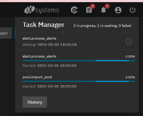

I've let this run previously for a long long time and it will not go beyond 0% and takes up all my cpu power that I give it and also keeps writing to disk?
For people googling this: alert.process_alerts pool.import_pool

is this the same version of TrueNAS so the ZFS pool version is identical?
are you installing on a new system and importing just one of the mirrors?
If DDrescue found no errors you may have a volume corruption issue. I have seen hard drives not dump the cache to disk when power cycled, this would be bad for you if this is the case.
No it is not the same version.. Didn't know this was a thing. I don't know what version it was, but I tried it then and it also didn't work.
I am using a new system (proxmox with truenas and drive pass through) and yes I'm importing just one of the mirrors.
Volume corruption issue doesn't sound great.. I'm gonna google it but is there anything I can do right now?
