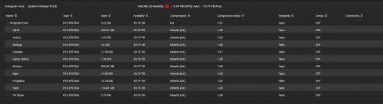

Hi Everyone,
Need some advice .. I Noticed today that one of my pool's is unhealthly but cant seem to figure out why .. everything from my little understanding of TrueNas looks fine .. So could use some help ..
Thanks ..
9,700
You need to click the cogwheel to the right of the pool name and select "status" to see what's going on.
It's likely you have some read/write or checksum errors on one or more disks.

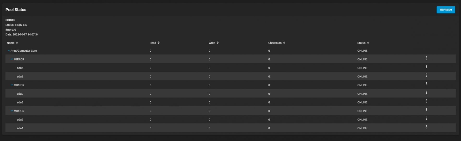

StarTrek133
Sep 5, 2022
112

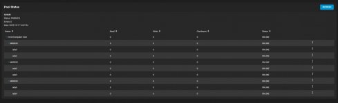

Yeah I thought it might be something like that .. but when I click its all zero's .. So I am confused ..

Samuel Tai
Apr 24, 2020
5,399
This is likely due to SMART errors on drives. Run a SMART long test on all your pool disks.

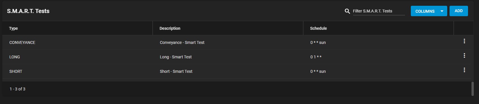

StarTrek133
Sep 5, 2022
112

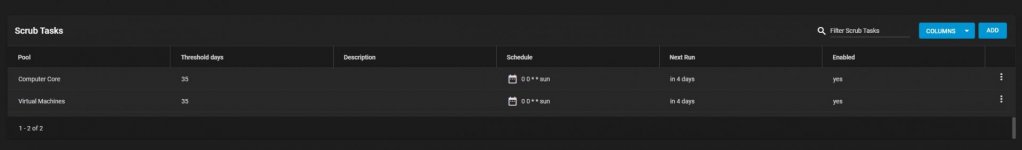

Thanks Samuel .. I get up the following and Hope I did it right .. So will just have to wait and see ..
Samuel Tai
Apr 24, 2020
5,399

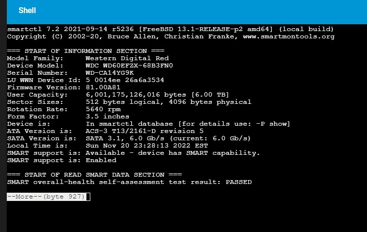

No need to wait for the scheduled tests. From Shell, run smartctl -t long /dev/ada0, and repeat for the other drives in your pool. Run smartctl -a /dev/ada0 | more periodically to see when the test finishes, and again after test completion to see the results.

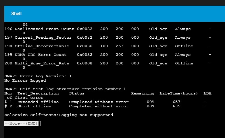

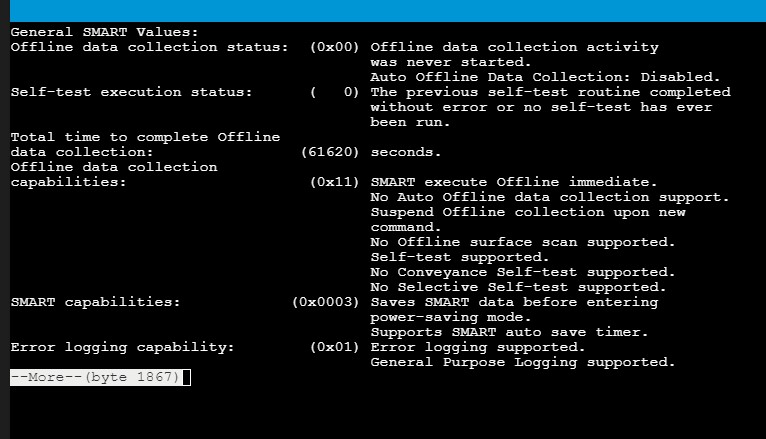

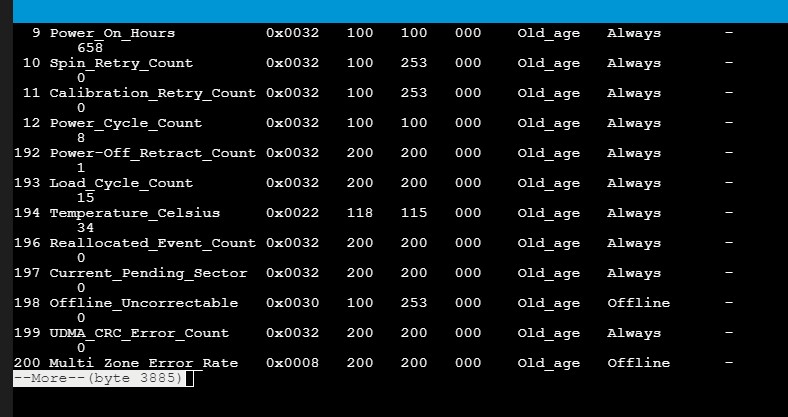

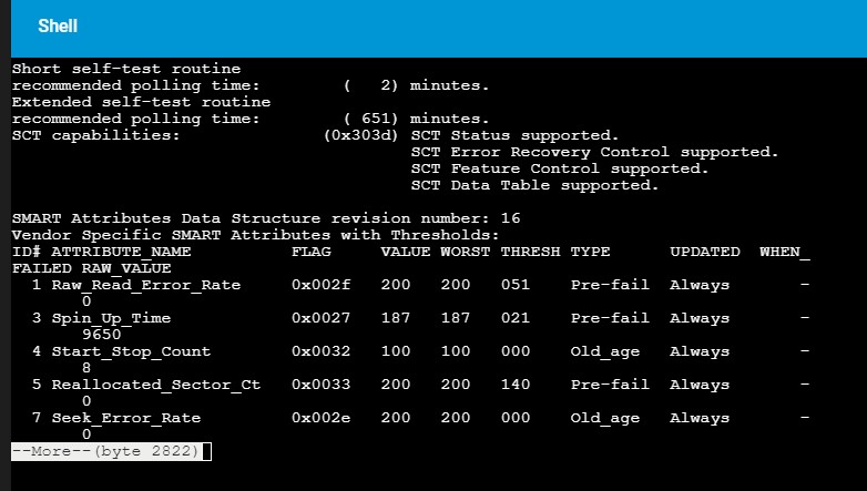

Hey Samuel .. sorry to say I don't see that I must be missing it .. here is the out screen shots .. hope they help ..

Samuel Tai
Apr 24, 2020
5,399
Look at screenshot 232912, about 4 lines down. There's a header titled Self-test execution status. In your case, the test completed, as you can see in screenshot 232949.

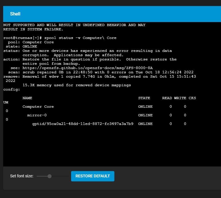

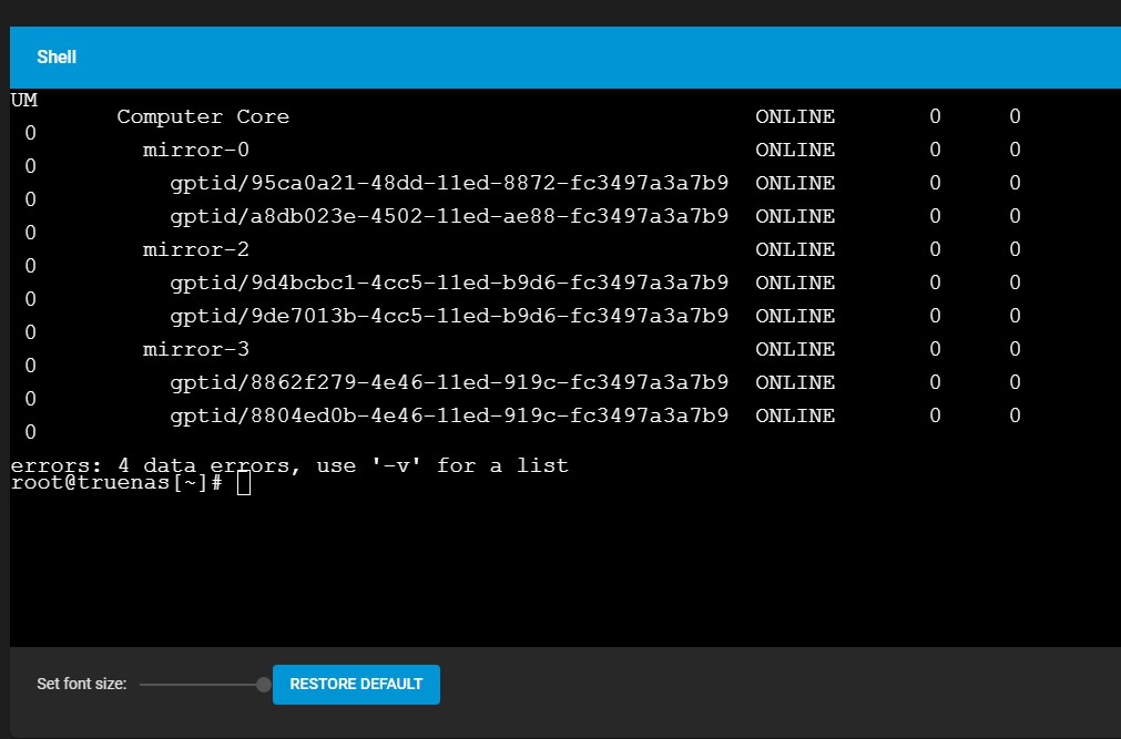

What does zpool status Computer\ Core say? Note, the error message may be a function of the pool name having a space in it.
StarTrek133
Sep 5, 2022
112
From what I can tell says everything is fine ..

Samuel Tai
Apr 24, 2020
5,399

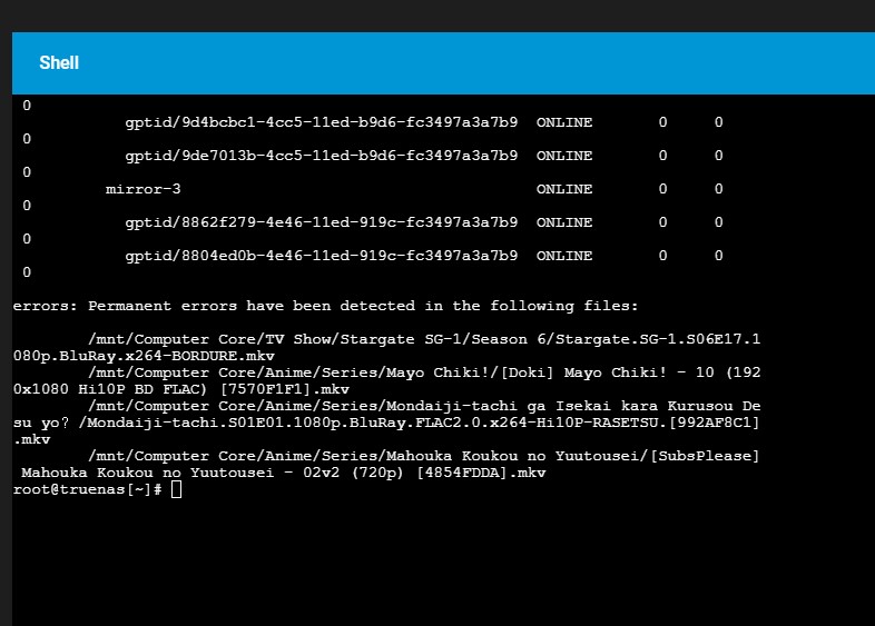

Please rerun with zpool status -v Computer\ Core. The error message indicates you may have damaged metadata.

This is what came back ..
So I have bad files I would assume ..

Samuel Tai
Apr 24, 2020
5,399
Yes, try deleting those files and running a scrub. This should restore your pool to health. Then restore those files from backup, and run another scrub.

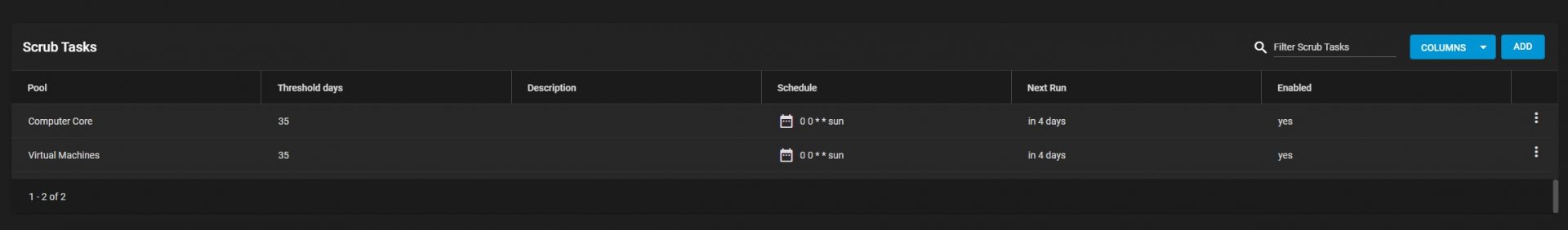

Hey Samuel .. Thanks again for the help .. I let it run over night and its back to being Healthy again .. So let's hope I am good .. I also found this and set it up .. I hope ..
Still new to all this ..
