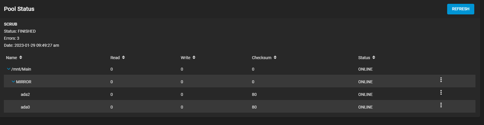

Hi everyone, I am pretty new to this and have set up my simple Truenas server to hold all my pictures/video files. I repurposed an old gaming PC I don't use anymore and just put in two new western digital drives. My specs are in my signature.
I was transferring files from my server to my laptop and suddenly got the error from Windows "Error 0x8007045D: The request could not be performed because of an I/O device error".
I then did some googling and ran a scrub on my system. I am seeing the following. One possible cause is the SATA cables needing to be replaced or reseated. I used SATA cables that I know work but are not brand new, restarted the system and ran the scrub again.
After rerunning the scrub I found the follow code to run on the command prompt for more detail -zpool status , and got the following results.
config: NAME STATE READ WRITE CKSUM Main ONLINE 0 0 0 mirror-0 ONLINE 0 0 0 gptid/c141522f-9805-11ed-976f-c86000c0be66 ONLINE 0 080 gptid/c149fcd9-9805-11ed-976f-c86000c0be66 ONLINE 0 080 errors: 4 data errors, use '-v' for a list pool: boot-pool state: ONLINE scan: scrub repaired 0B in 00:00:06 with 0 errors on Thu Jan 26 03:45:06 2023 config:
So it looks like there are no errors? I then was able to identify the 4 files with errors which are video files. I also ran full short and long SMART tests on the drives and they came back with no issues.
So my questions are as follows:
  1. How do I remove the errors? I tried to clear them and run the scrub again and it came back.
  2. Is there a way to save the 4 files? I try to copy them out of the server onto my desktop and it almost completes and then fails.
  3. Should I get new SATA cables? Could it be the hard drives? Could it be the power supply?
  4. Should I immediately back up my data? Right now it is all just on these drives.
Is there anything else I should try, I would really appreciate anyones help here. Thanks!

My offhand guess would be that it's an SMR drive, they tend to blat out a bunch of errors all at once when they're having trouble. Do you have the exact model number?

Oh yeah, that's an SMR drive.

Is that the hard drive? They are brand new but I guess they can fail? It is WD20EZBX
According to WD, that's an SMR drive.
SMR drives are basically archival drives that are not particularly good with copy-on-write filesystems such as ZFS. There's a lot already written on the topic if you wish to know more, just search for "SMR ZFS" or something like that.
