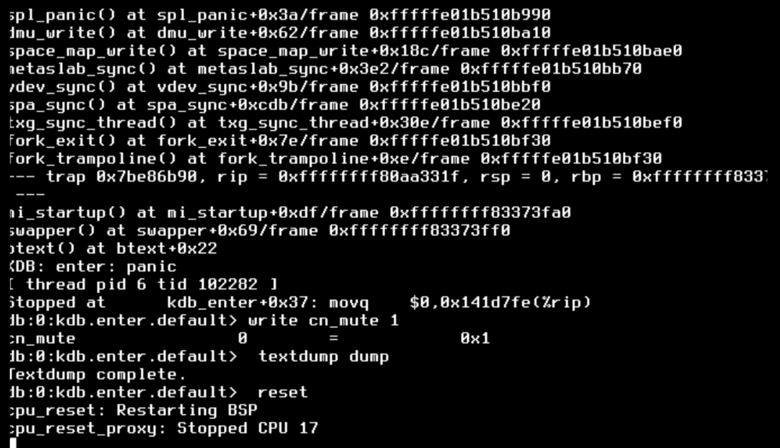

As the pool utilization was on 97%, we planned to attach JBOD by installing additional LSI. We attached the JBOD to TrueNAS and booted the server. Initially, the existing pool appeared healthy, but within a minute, the server experienced a kernel panic and restarted automatically. After rebooting, the server began reporting I/O errors, and the pool became degraded despite no disk failures being detected.
We performed troubleshooting to the best of our ability but have been unable to resolve the degraded pool issue. Notably, there is no drive showing as failed. It appears that the storage appliance is retrieving outdated disk information for a drive that failed long ago and was subsequently replaced. As a result of this degraded state, the customer's backup volume, the F drive with a size of 25TB, has been rendered into a raw partition.

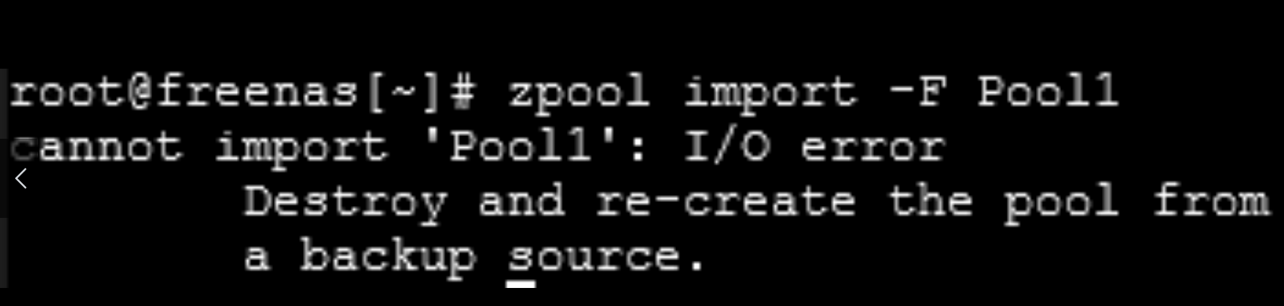

As soon we execute import, server trigger kernal panic and restart. Then we upgrade the Freenas to Truenas and executed import pool and now server does not restart, but giving I/O error.
Before upgrade this is what the error we were getting, when executed import

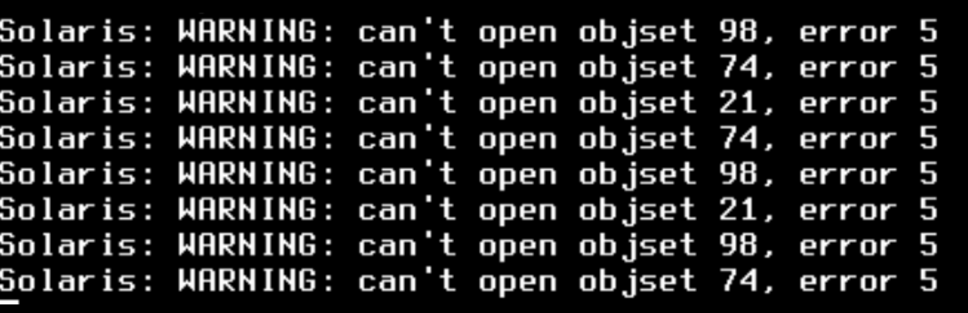

After upgrade this is the error we are getting
