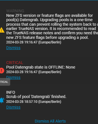

you mean the error message regarding the "new zfs version" ? no didnt look at it since no clue why thats there.

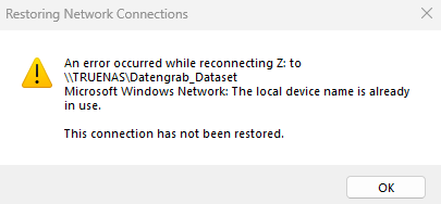

its listed as degraded but i can't access it from windows
and its weird that i can add it as readonly but not normally...

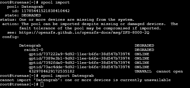

zpool import
zpool import
   pool: Datengrab
  state: DEGRADED
status: One or more devices are missing from the system.
 action: The pool can be imported despite missing or damaged devices.  The
        fault tolerance of the pool may be compromised if imported.
   see: https://openzfs.github.io/openzfs-docs/msg/ZFS-8000-2Q
 config:
        Datengrab                                       DEGRADED
          raidz1-0                                      DEGRADED
            gptid/737222a9-9d92-11ee-b6fe-38d547b73974  ONLINE
            ada1p2                                      ONLINE
            gptid/7392fda0-9d92-11ee-b6fe-38d547b73974  ONLINE
            gptid/73ac4dde-9d92-11ee-b6fe-38d547b73974  ONLINE
            4329784629172535182                         UNAVAIL  cannot open
zpool import Datengrab
cannot import 'Datengrab': one or more devices is currently unavailable
when i do zpool import Datengrab -F -n i get nothing returned and nothing gets added
it would have been possible to import the pool in the degraded state other than readonly.

https://openzfs.github.io/openzfs-docs/msg/ZFS-8000-2Q looked at it and tried the stuff but didn't work and didn't know how i should replace that disk via shell with the replace command
