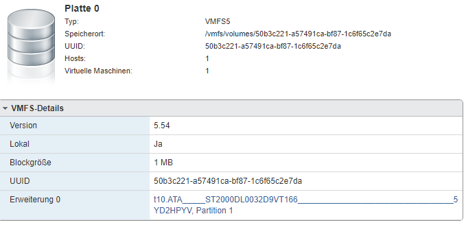

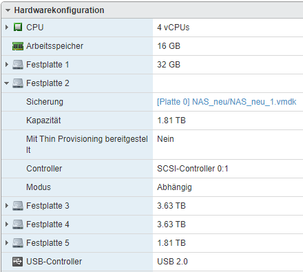

"You are using ESXI. How are you passing the disks into the VM? This should be done with some sort of hardware passthrough that needs VT-d. "
I hope this picture shows what you need:
The other HDDs are similar "plugged" into the FreeNAS-machine.
The storage in ESXi for this HDD is:
This system worked very well the last years...

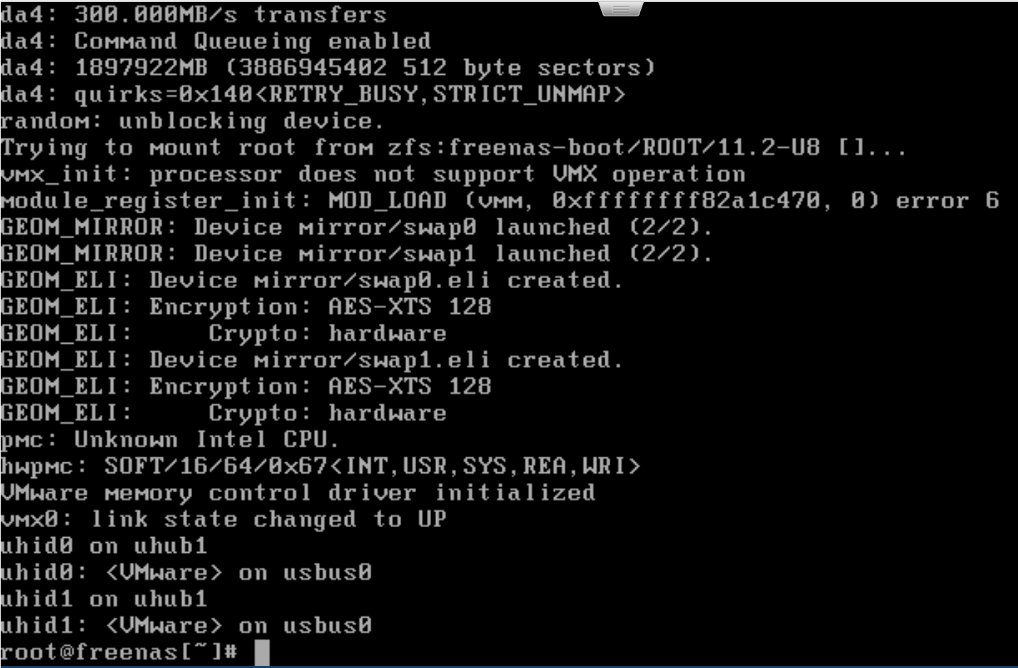

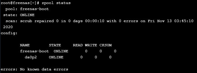

"Also, could you post the output of zpool status?"
I hope this is what you need:

Maybe it has worked well for you (and you were riding the razor's edge with a lot of luck so far in that case), but it's now time to reconsider.
You're running virtualized, but you're using virtual disks from the VMware system to pass into FreeNAS... this is a recipe for disaster (and disaster may have already arrived for you).

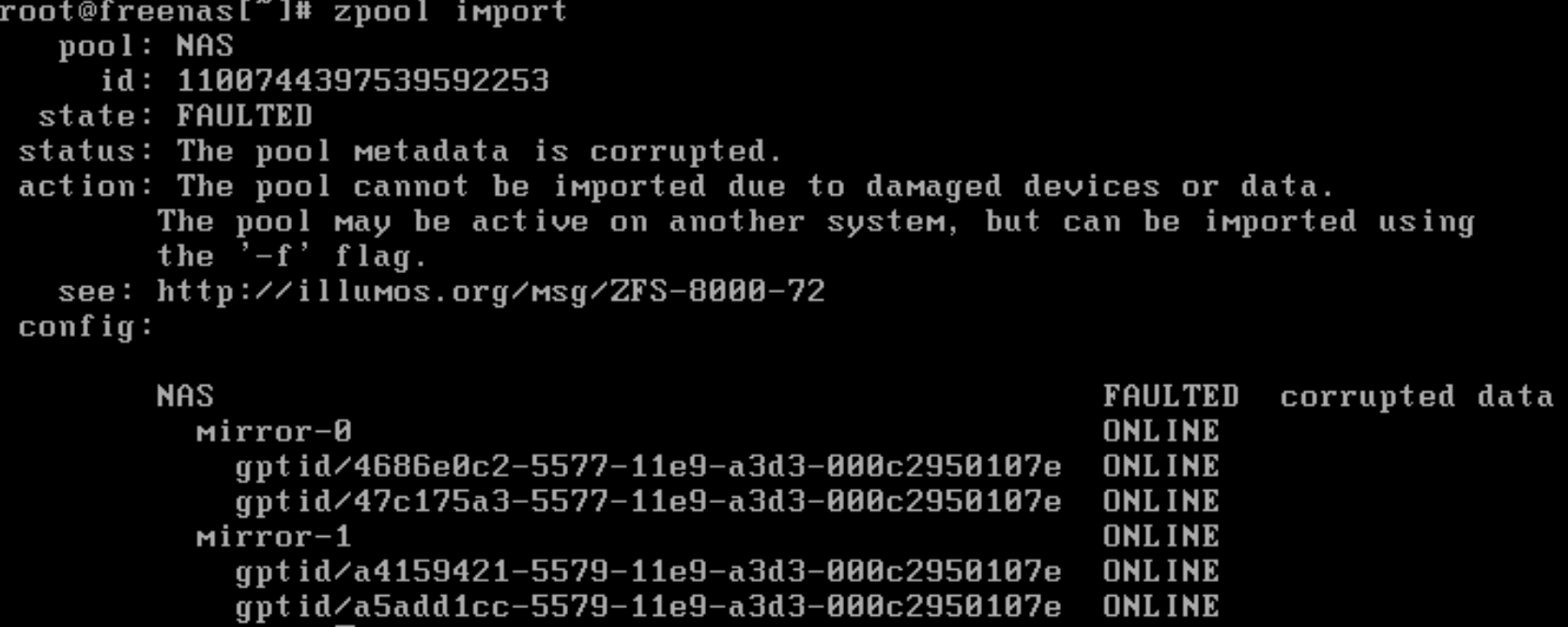

Then I would suggest that you look at the output from zpool import to see if the disks are still in play.
Also look at dmesg to see if anything useful is being reported.
Importing a disk is not what you need in this case, it's importing a volume (I think that's how it was labeled in that version, even though it's actually a pool that you're importing)
If you manage to re-import your pool I wouldn't let it sit like it is any longer if you care about the data that you have stored there. You need to do a re-think according to the thread I referred above and pass the disk controller throguh to the VM, not individual virtual disks.
It does look like you have a pair of mirrors, probably one of 1.8TB and one of 3.6TB. They may be VDEVs in one pool, or two separate pools. We'll see if zpool import shows you anything.

zpool import shows:
How do I get an output page by page? When I try dmesg, I get only the last part to read:
And: By all: What does this say to me?
The only thing I know: I have had just one (1) pool, named NAS....

As mentioned before, you've built this pool in a perilous manner (VMDKs on top of a VMFS) - the sudden power outage may have introduced corruption in your VMDKs.
You could attempt to import with zpool import -f but I would suggest also adding -o readonly=on to ensure that no further damage is done; assuming what has already happened can be recovered from.
