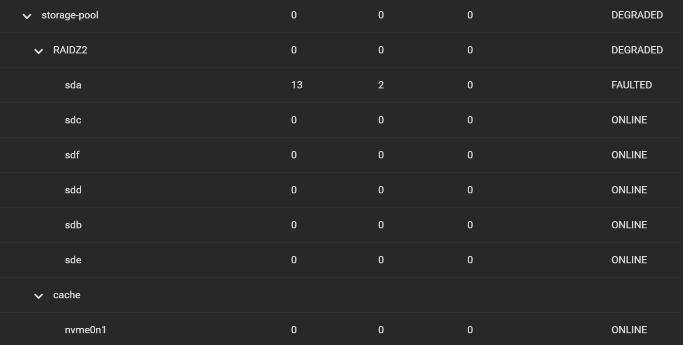

Started a scrub last night and just woke up to this. Joy.
  pool: storage-pool
 state: ONLINE
status: One or more devices has experienced an unrecoverable error.  An
        attempt was made to correct the error.  Applications are unaffected.
   see: https://openzfs.github.io/openzfs-docs/msg/ZFS-8000-9P
  scan: scrub in progress since Thu Sep  8 16:18:44 2022
        46.3T scanned at 1.00G/s, 43.3T issued at 959M/s, 47.8T total
        1.09M repaired, 90.64% done, 01:21:34 to go
config:
        NAME                                      STATE     READ WRITE CKSUM
        storage-pool                              ONLINE       0     0     0
          raidz2-0                                ONLINE       0     0     0
            1766c859-9231-4127-ad35-882937845b76  ONLINE       0     0     0
            89b557d9-cc55-463c-9124-3765cff9aaac  ONLINE       0     0     2  (repairing)
            4a07f2eb-442c-430d-9db6-0e5fd80302a9  ONLINE       0     0    32  (repairing)
            c6287e21-49e0-4ffe-86a1-78a33bbbec70  ONLINE       0     0     0
            1c817e68-35de-4b8c-be59-4e98fc1fc9fe  ONLINE       0     0     1  (repairing)
            28dba822-3f63-4e2c-82ad-8e4467bc81a1  ONLINE       0     0     0
        cache
          f5456732-9153-44fb-977b-fe5f1021b959    ONLINE       0     0     0
errors: No known data errors

Let me clarify something.
You used to get DEGRADED or FAULTED drives before, yes?
Now they remain ONLINE, yes?
Having the drives remain ONLINE indicates that the TLER, (Time Limited Error Recovery), is now working. And perhaps you had a few bad blocks that ZFS could not correctly spare out the bad blocks because of the the drives dropping off-line, (aka DEGRADED or FAULTED).

Nope, still happening.

k0d3g3ar
Nov 12, 2017
6
FWIW, I've had similar situations happen to me before with 18TB drives. And they were WD drives.
Strange thing that solved this for me was to scrap the drives (They were REDs) and replace with the HGST versions. Once I used those "Enterprise" drives, all my problems went away. And I got the issues with RaidZ configurations with HBA Broadcom card interfacing everything. And on a decent server with a ton of memory. I can't speak to WD Gold, but I saw major improvements with HGST drives here. Of course, YMMV.
buswedg
Aug 17, 2022
69
@buswedg
By any chance: Is Link(State)PowerManagement enabled in BIOS? If so, turn it off. As well as any other power management feature that could affect onboard SATA or PCI(e) (again: in BIOS).
If You plugged drives back to HBA, You can ignore the onboard SATA power management.
I've still got the drives connected to the expander. I can try and move them to the mb headers. I was hoping that the timeout setting was going to fix this, so didn't end up making that switch.
Oh, and I see a setting here in the BIOS:
SATA and RST Configuration --> Aggressive Link Power Management --> Enabled
Should I keep that disabled either way?
buswedg
Aug 17, 2022
69
Yeh, I'm worried this might be the case. Particularly something funny happening with TrueNAS and this type of large capacity WD drive.
awasb
Jan 11, 2021
415
Please try to switch. The shorter the "chain" / the less complex your setup, the easier it is to sort out causes of error. AFAICS Your MoBo has enough ports to do it without any additional effort. (Please select Southbridge -> SATA and RST Configuration -> Configure SATA as to "AHCI". Don't - under no circumstance - set it to "RAID", please.)
And yes: please disable all sort of (possibly related) ACPI options and other "advanced" power management (like rapid storage extensions). Just for testing and to be sure, nothing else get's in your way.
Arwen
May 17, 2014
3,611
@buswedg - Hmm, I don't see in the SMART output what I expected. Unless this is it;
0x0c GPL R/O 30001 Pending Defects log
My skill with SMART output is limited, perhaps someone else can help further.
But, at least the issue now seems to be with just 1 disk. Let us know if any other disk starts throwing errors.
Or, maybe disabling this option will help;
buswedg
Aug 17, 2022
69
This is typical behavior of the problem. It is sometimes one disk (never the same disk). Sometimes multiple disks at once. Often both read/write errors. Which, when cleared and scrubbed, lead to subsequent checksum errors. I've not seen sda show read/writes more often than other disks.
And I imagine that BIOS setting will only effect drives connected direct to the mb headers. I've got my boot pool and another drive connect direct to the mb at the moment. But, they aren't part of the array.
I'll take the advice here and disconnect the array later today, then shift all drives direct to the mb. I'll the re-import and see how we go. I think this is either going to be a) some unrecognized incompatibility between TrueNAS SCALE and these types of drives or b) I've been extremely unlucky and got two dud HBAs, and/or two bad set of cables.
I don't think the drives (in terms of hardware issues) are a problem. I've been watching the smart outputs pretty closely. And spent a week doing burn-in with badblocks etc.
FYI -- I did end up making that BIOS setting switch, so that doesn't create an issue while I test out the new setup.
buswedg
Aug 17, 2022
69
Ok, some other good news. I got in touch with a friend who can lend me a ThinkSystem 430-16i HBA and cables for a while. I'm pretty sure that card should be compatible with TrueNAS.
I'll still try the switch direct to the mb. But if that ends up correcting the problem, this would be another good way to then confirm that my current HBA and/or cables are the problem.
I guess if I see the same issue using a new HBA + cables and don't see the problem when connecting direct to the mb, then at that point, I'll probably end up throwing the server out the window.
