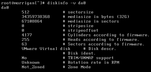

When I try to create the pool in FreeNAS I get the following error:
Failed to wipe disk da5: [EFAULT] Command dd if=/dev/zero of=/dev/da5 bs=1m count=32 failed (code 1): dd: /dev/da5: Invalid argument 1+0 records in 0+0 records out 0 bytes transferred in 0.000605 secs (0 bytes/sec)
Each time the error identifies a different disk. I tried running the dd command from the command line with no success.
I am open to any suggestions. I attached an image of diskinfo output and information about the drives at boot up.

When I choose quick wipe I get the same failure message for each disk. When I try fill with zeros or fill with random it starts but shortly thereafter it closes while never getting above zero percent complete. I can mount the array on a Linux guest and see if it works or to get better visibility of any error messages. More to follow.
