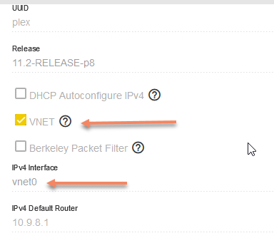

Hey everyone,
Since 11.2-U2 having issues with Plex. I got the plugin to install by adding an interface, but the poster art doesn't pull in and only adds a scene from the movie. I added an interface for my FreeNAS and defined the DNS-servers but this didn't work.
1. I have cleared all meta data and rescanned, still only uses a scene from movie
2. added DNS server 8.8.8.8 and 8.8.8.4 to the global network address of FreeNAS box
Any ideas are appreciated.
Jailer
Not strong, but bad
Sep 12, 2014
4,977
Do you have a default gateway listed in FreeNAS? Also is vnet enabled for your plex jail?
mrutt
Feb 23, 2019
6
Fixed, thank you so much. For others that might be new to FreeNAS, I took a screenshot.
