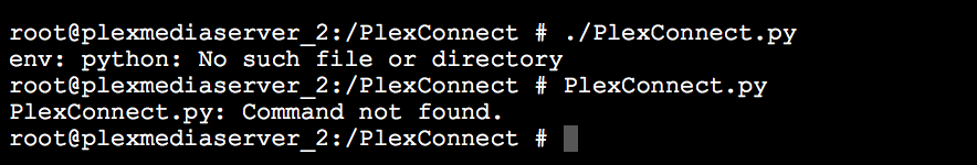

Sorry to bump something so old, but I can't ever get it to run.
Followed the Nas4free thread instructions and can't get it to run the first time:
Stuck at: "Start PlexConnect so it creates Settings.cfg"
Screenshot attached of what I'm getting.
Thank you for any thoughts!
Oct 29, 2013
8
Thanks.
I figured it out - Had the wrong python folder set in Settings.py (needed to by python2.7 instead of just python)
